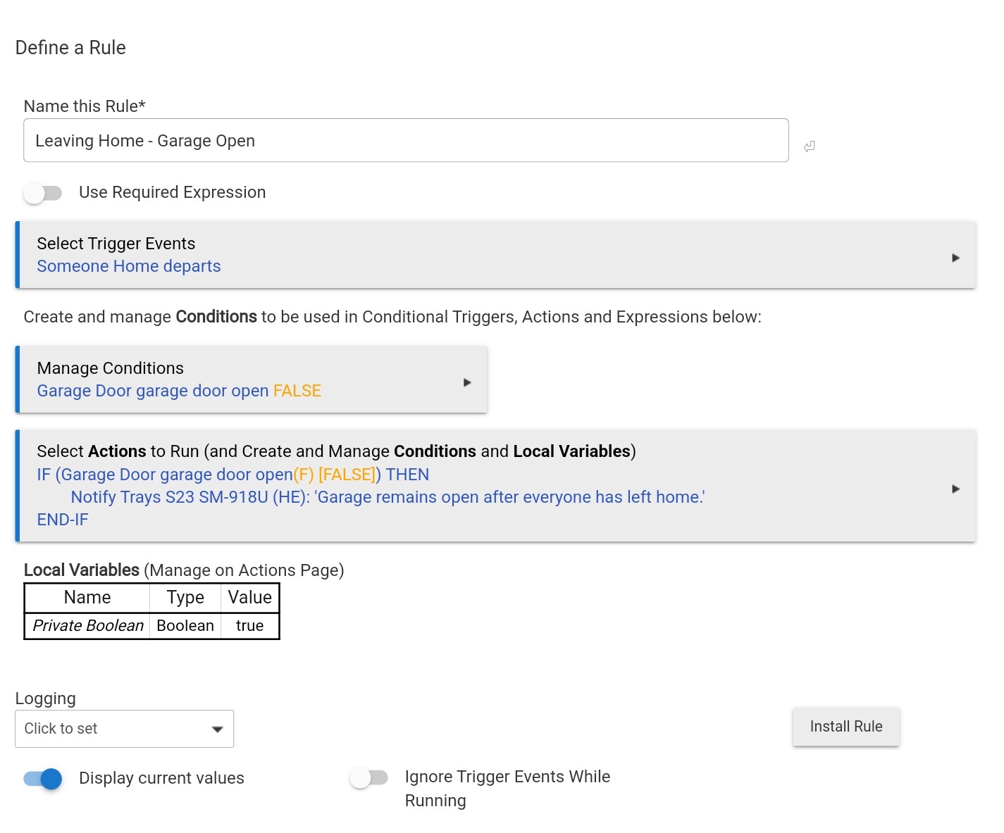

Yes, it would look something like this in Rule Machine. I actually use webcore for this because mine is a little more complicated. I have notifications sent to the person who left with the door open instead of everyone.
You also might want to add a delay in there to avoid getting a notification while it is still closing if your geofence has a really small radius.

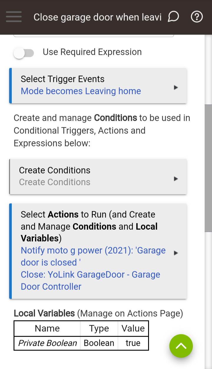

Here's what I did. My only concern is does the garage door controller know open from closed?
I can't find if already closed don't run rule.
So if I'm leaving and do close the door, it doesn't open when out of the geofence.

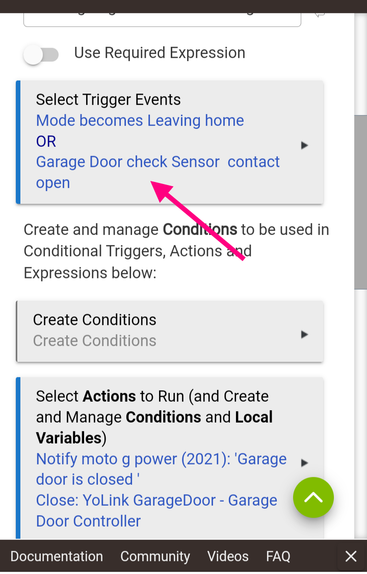

It's a yolink. Good point so I added the sensor.
Does this look workable with the "OR"?
Is there supposed to be a picture in that post?
