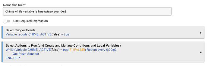

this is a screenshot though:
As I explained above... the trigger event fires but the while loop does not get to see the correct variable value because it probably didn't actually get written BEFORE the event triggers.. I have to write the value twice so that it triggers twice in order to make this work. First time it exits, and then the 2nd trigger works because by that time the value is written (and as I said, this is new behavior, I've had this rule for a long time and only became broken recently).

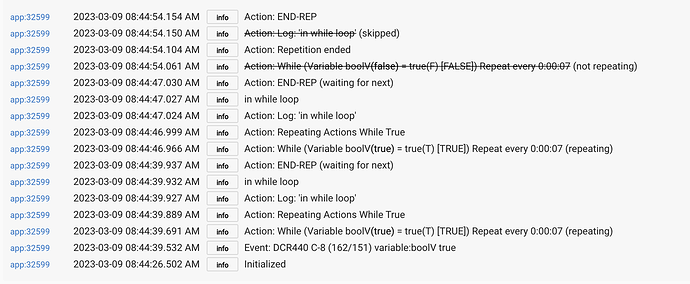

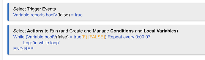

I created a similar rule, and tested it. It works as expected:
Here are the logs:
There is no lag between an event of a variable being set to a value and that value being "written". The new value is stored in the database, and that generates the event.
Yes thats what I looked at and I could see the event come in triggering the rule and then immediately exit the loop because the value was still false when the while looked at it.... so there is definitely some race condition happening.
Here you can clearly see it get the event... fail out of the loop, get a second event and then succeed. Nothing else is changing the variable in between. It should have been true in the first attempt to enter the loop but it wasn't.
