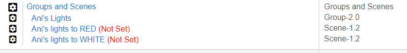

  • 1 Scene to turn both LED lights to Red mapped to S2 (Group: Lights)
  • 1 Scene to turn both LED lights to White mapped to S1 (Group: Lights)
  • 1 Group created with both lights (Group Name: Lights)

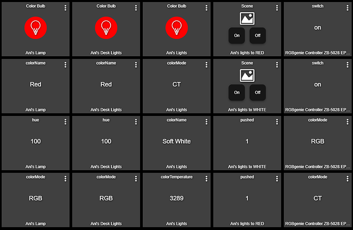

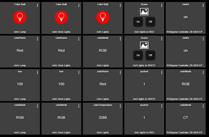

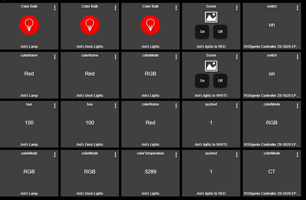

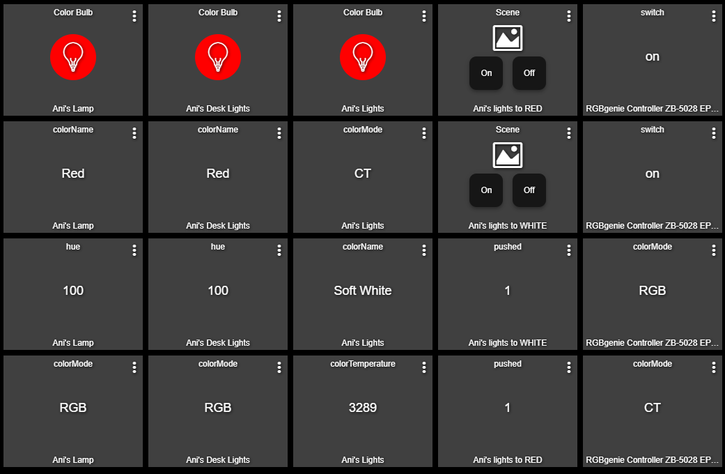

  2. The SB button sets the group to red/white, but not the individual lights.
  3. The "button pushed" attribute never changes, but logs show it is being pushed:
  4. Scene activation through dashboard and controller is not making the actual devices turn white or red.
  5. The "button pushed " attribute is not changing state when either the dashboard or controller is used.

  7. Using scene tiles and controller all-on/off does not always turn off the Lamp device.
  8. SB1 and SB2 on controller are not changing scenes. This works for awhile after capture, then stops working and I have to do it all over again. I don't understand why the HE scene is not being mapped correctly to the SBx buttons on the controller.

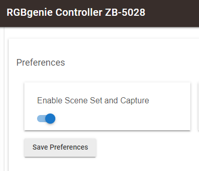

To enable scenes, the scene capture preference in the parent needs to be enabled.

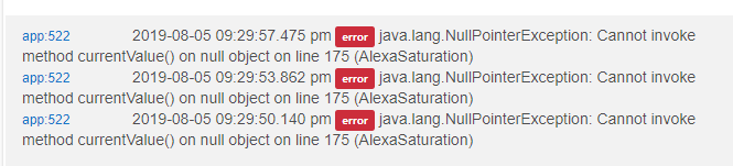

@mike.maxwell I am getting a java error for the group I created with the LED strip and Bulb. Any idea why?
Is this the correct type?
YF
From the device details page for the group device issue a setSaturation 100 command, that error should go away.
