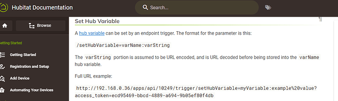

I'm looking at this: Rule Machine | Hubitat Documentation
I don't quite get why I need to have a rule to make this work but I'll try to work through this concept. I guess the API calls somehow leverage a rule which seems odd.
This documentation seems to assume we know what we are doing. Referencing access_token with no explanation of where to find it, how to set it up etc?
I believe an access_token is provided when you set up Maker API. I recall doing this to set up Locative presence sensing, but this is very confusing.
You do know what you're doing. :slight_smile: This is accurate (and the docs mention it, which is I assume where you got it from):
And that is because when you add a local (or cloud, depending on your needs) endpoint trigger to a rule, you will get a URL. You can use that URL as a start, modifying the paths or parameters as needed. It includes the access token (and the app ID, which you will also need--the 10249 in the example above).
