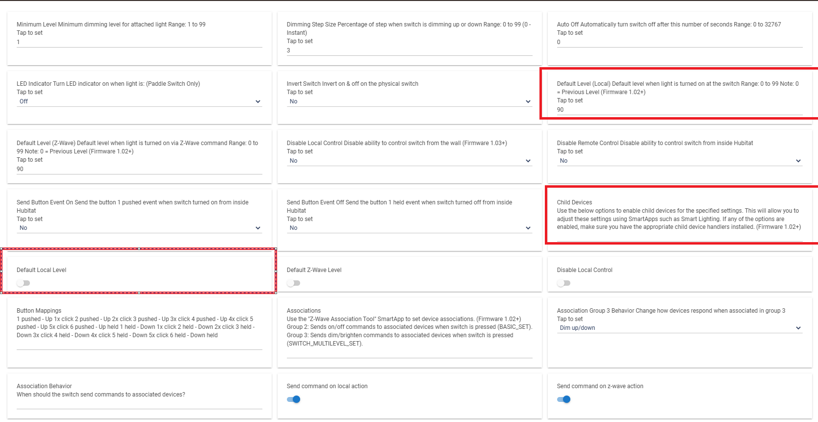

It depends on what the drivers for the switches support. I have some Inovelli switches that have a "on level" child option. So if a modes changes in the home say to sleep the bedroom and other lights will only come on to 20% when setting the child value to 20%.
I also have been experimenting with using the "don't control the load" from the switch which when a button press is made at the switch I take that button event run it though rules on the hubitat and then send the command back for the right level. My only concern with this approach is if the hubitat is down lights don't come on. Below is the configurations I can see with the custom Inovelli drivers:
I was using the "default local level" option but this would but a lot of wear on the non volatile storage the switch. I don't know what the write cycle is for storage so then I switch to default local level child device.
