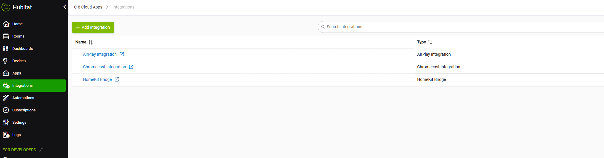

The AirPlay Integration might give you a way to use the HomePod...
Yeah, but no HE. :slight_smile:
I think the OP means he either removed the Hubitat hub from his house or has moved to a new house without Hubitat.
