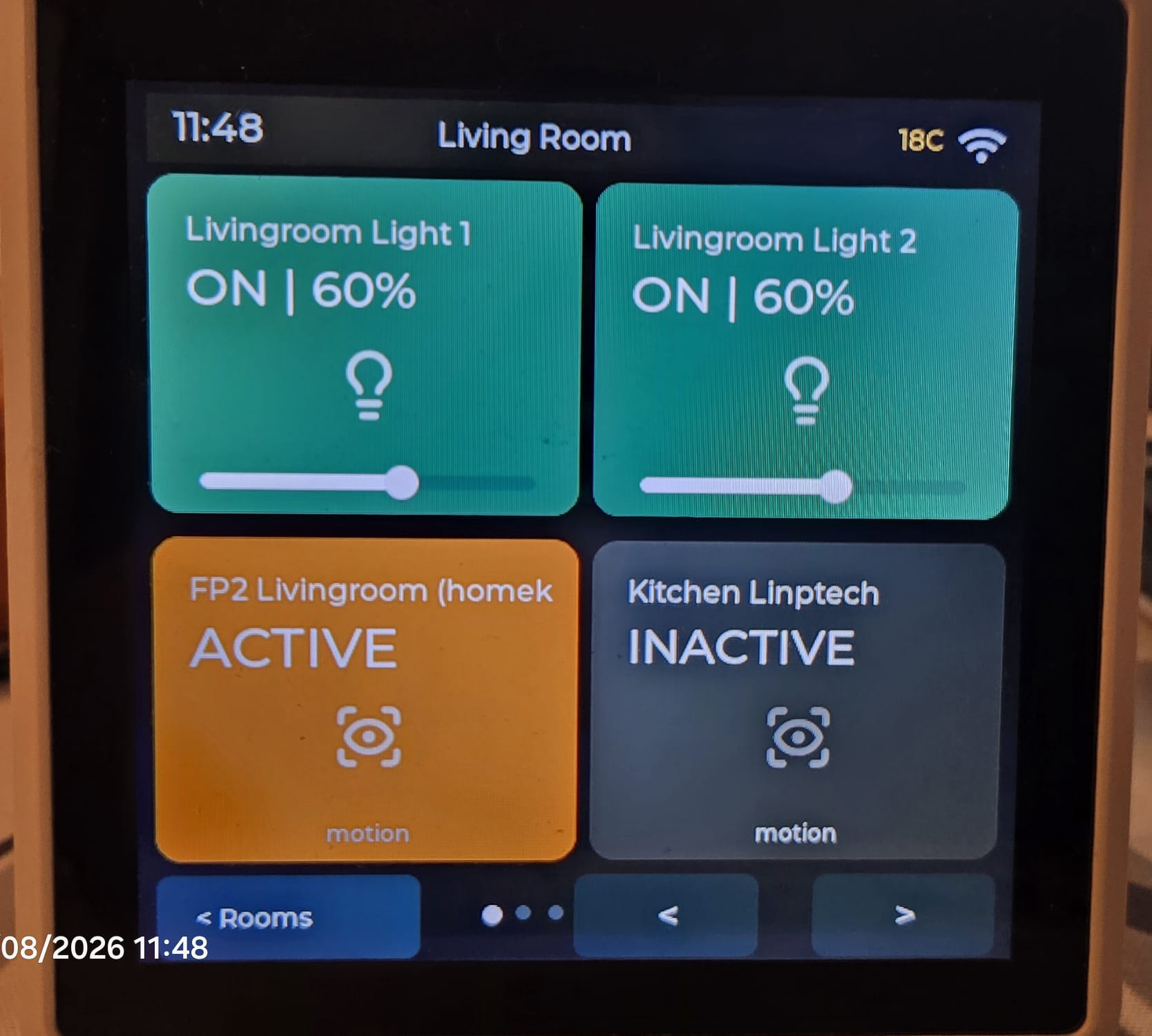

  • The D1 should show a Rooms screen with tiles for each room your devices belong to
  • Tap a room to see its devices; tap a switch/light tile to toggle it — you should see it change on Hubitat within a second or two

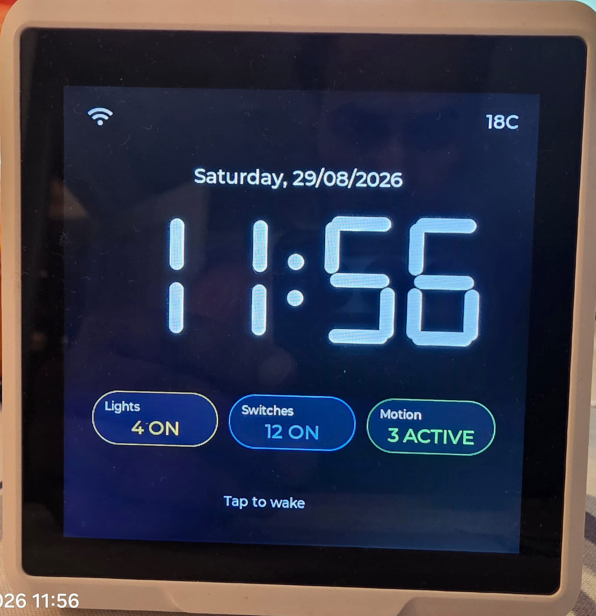

Another thing I found: the clock on the screensaver is not showing the correct time / not following the hub's time. i think a daylight saving thing at play here.
Also when displaying dimmer switches, the state is correct and responsive, but touch on the screen seems to be ignored.
So if I push the button on the screen to turn the light off / on / dimm, nothing happens.
If i do the same on the hub to that same dimmer, the command is executes immediately.
The screen follows the set state of the dimmer instantly.

Timezone is hardcoded for UK, lol.
Will fix asap.
Update to v1.1.0 available — fixes the touch-swallowing bug on light/dimmer tiles and the screensaver, and adds a configurable timezone.

Tested.
The timezone works, the light/dimmer not.
Can you please give me more details of the light/dimmer type you have and I will investigate further.

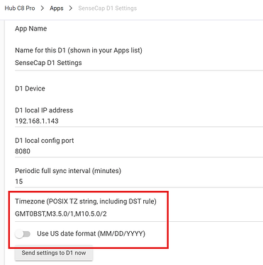

  • Configurable timezone — the on-screen clock previously showed a fixed UK time regardless of where you actually are. Now it's configurable, and auto-detected from your hub's own Time Zone setting for most common regions (US, UK, most of Europe, Australia, and more) — usually nothing to set up at all
  • US date format option — toggle between DD/MM/YYYY and MM/DD/YYYY, also auto-detected from your hub's timezone
