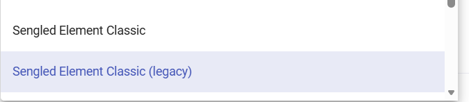

You are not imagining this, the same here the ones in the basement have been rock sold and some in individual rooms have been experiencing the same issue you have seen. What I found out is that. Of the list of bulbs I have and the key was the "Generic Zigbee Bulb" seemed to be the driver that didn't have the issue. Where the ones that had the issue used the "Sengled Element Classic" driver.
But I noticed something in the latest firmware:
"I am now testing the Sengled Element Classic (legacy)" and they have been rock solid since I made the change to the driver on Friday.
I would say there has been some changes in the Sengled drivers by Hubitat that is causing this with the legacy bulbs, someone realized it and pushed out the "Legacy" version of the driver.
I may be wrong on this but I think the Sengled Element Classic (Legacy) driver has been there for a long time. Seems like I remember seeing it a year and half or so ago when installing some bulbs, but like I said I may be wrong there.
I use several Sengled Element Classic bulbs and I am using the Advanced Zigbee Bulb driver with them and have zero issues with them. If the switch in the drivers you are trying doesn't work I would give that one a shot.
That's the one I have selected. Will try the "legacy" driver and if that doesn't solve it, will try what @LearningHubitat is using.

Does anyone know what the difference with the "(legacy)" driver is?

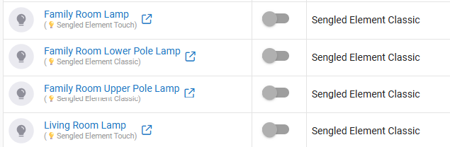

This is what has me so baffled - there have been changes to the devices (adds/removes) etc. for quite a while and so nothing should have changed. Firmware is 2.4.3.176 and that was probably the last change (t was a while back).
The same bulbs have been working on the "classic" driver. I checked all my zigbee bulbs and all of them were the same. I've switched to the "legacy" driver and waiting to see what happens (so far, it's looking like it is working, but that's not to say that if I switched back things would go in the crapper again :man_shrugging:t2:)

I'm going to see if the driver switch resolves the issue. If not, then the next step is to exclude/re-pair. It's a pain as they are in a lamp and the 10 on/off drives me up a wall! - I will have to bring them down and plug them in to a switched outlet.
