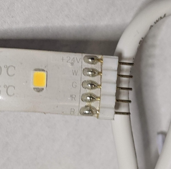

After removing the heat shrink and separating the strips from the controllers this is what needs to be replaced.
One is a 24V RGBW strip, actually 2 strips 10 meter, kit.
24V 1.5A 36W 5Pin: Vcc,W,G,R,B (pics below)
The other is a 12V RGB 6 meter pretty basic strip.
12V 1.7A 20.4W 4Pin: B,R,G,Vcc (pics below)

Just had another sift through the spare parts shelf (okay more of a room these days), and found this (no longer available :slightly_frowning_face:) Tuya TS0503B TZ3210_95txyzbx controller from an Amazon deal a while back.
Combined with one of these 4pin connectors (found some in a bag of cables :wink: )
And... it seems to work fine using this driver:
Tuya Advanced Zigbee RGBW Bulb with healthStatus driver for Hubitat
No idea what the power rating is for the ZigBee controller but since it's here, will see how long it lasts. :wink:
