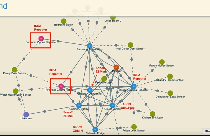

Below is the routing map from my C-8 and it looks like the issue may be the 2 IKEA Repeaters outlined in RED (interview failed according to the community app)? The devices that are currently not responding are the Pantry Door Sensor and the Water Heater Leak sensor

I think my issue may have been the two IKEA repeaters that had fallen off the Zigbee network. I reset and paired them again and the devices that had fallen off suddenly started working :crossed_fingers:t3:
