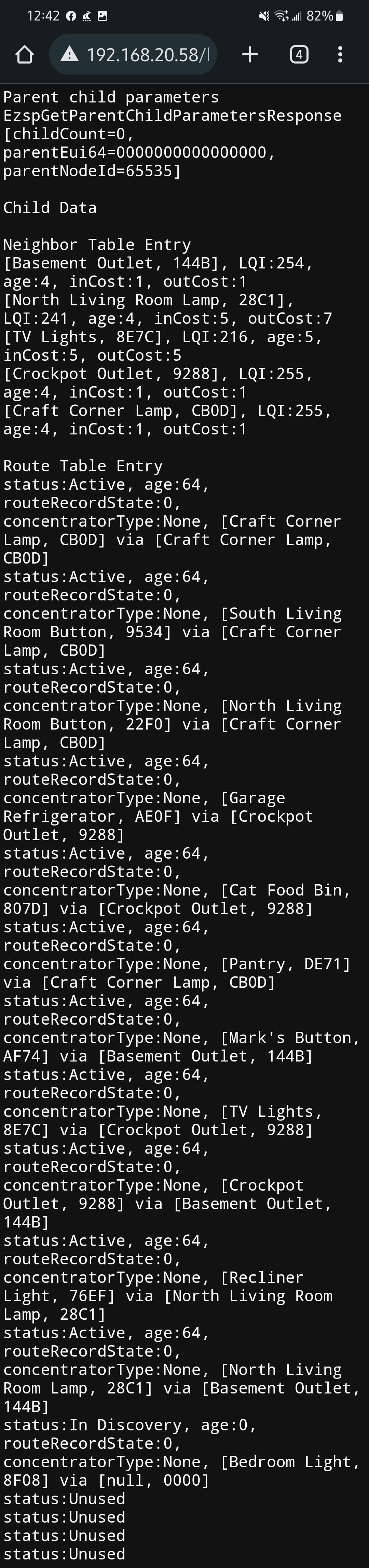

Do they show up in the Zigbee routing table?
http://hubitat-ip-or-fqdn/hub/zigbee/getChildAndRouteInfo

http://hub-ip-here/hub/zigbee/getChildAndRouteInfo
I've seen this stuff before but never really know what to look for
I'm not a Zigbee master (mine has always worked well so I've never really had problems to troubleshoot) but you want:
LQI >200, hopefully near 255
Incost/Outcost as close to 1 as possible
Devices in your neighbor table who aren't doing well on those numbers may not be great repeaters.
In your routing table see which device are routing through which routers, that could tell some tales.
Something you could do that's no cost/simple, is shut down your hub for 25 minutes. That will put all your Zigbee devices into panic mode and they will re-route when your hub restarts. That may result in better routing choices. You can take before/after screenshots of the child and route info to see what changed, if anything.
