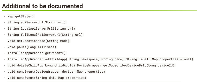

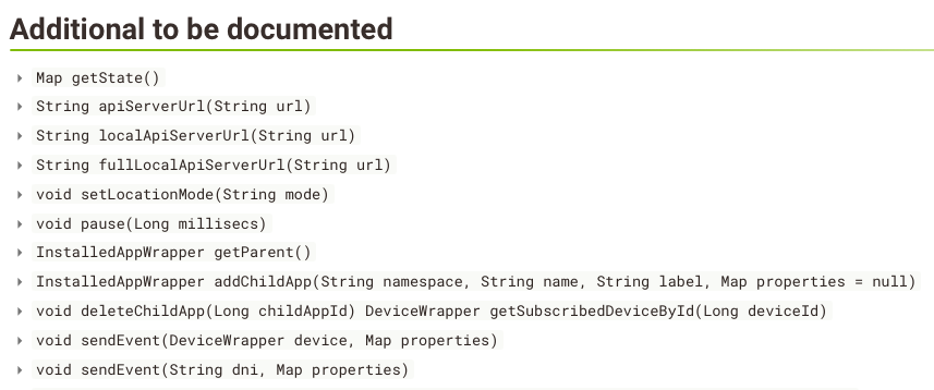

New one on me (although it is documented for apps) - sounds like a security flaw that should be patched.
Eh, it's "documented":
Seems pretty intentional.
And just removing it would break a bunch of apps that currently use it. Plus that's hardly as much security issue as being able to put something like this in an app:
