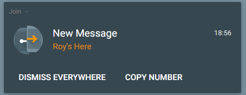

You should check out join. @stephack made an excellent driver and posted great instructions. It may be able to do what you want.

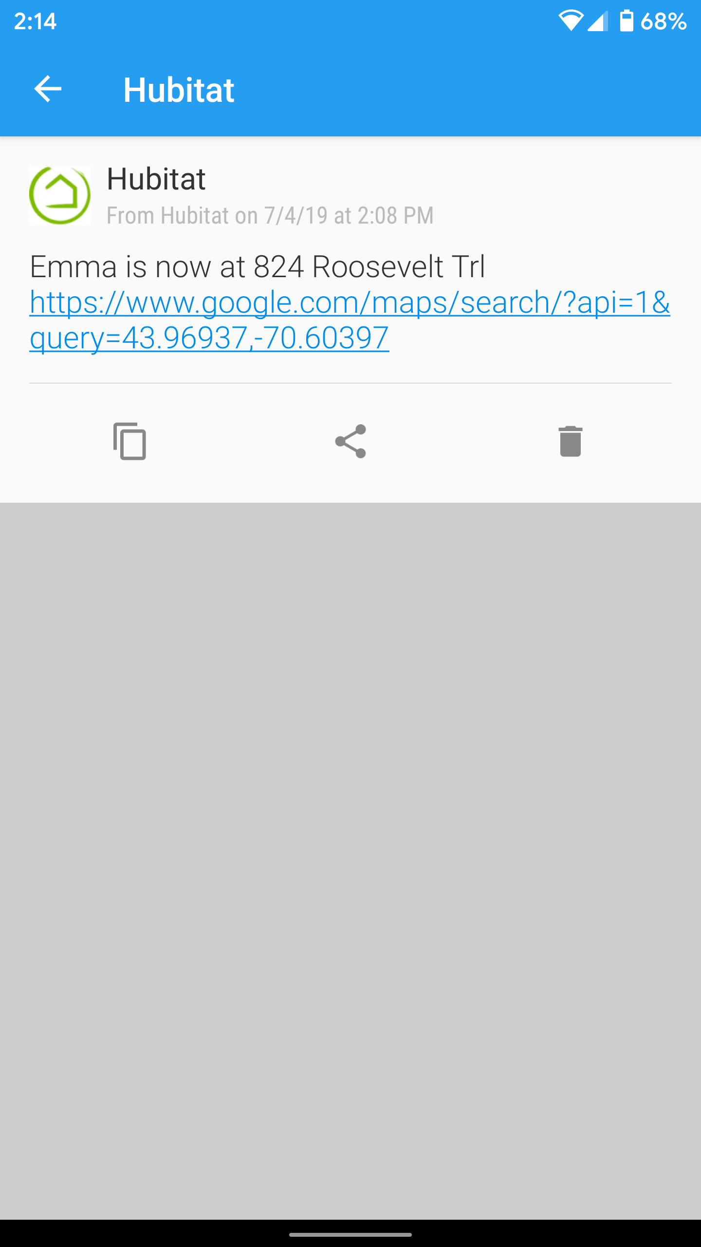

yeah, I've heard about it but was looking for something built in for the masses. Wanted to send a push like...
Emma has arrived at The Park
Map to The Park
Using the lat, and long from Life360 with States. I can make the url easy enough but couldn't figure out a way to send it to Pushover.

Well. You can send you message with separators he has defined [cc]and it allows you to manipulate the different options the driver has for creating notifications.
Join allows you to setup numerous different kind of actions that can be ran from an android device.
These actions can be presented as buttons within the notification. Those buttons can be picked based upon the above custom formating.
So for example if I can pass the url into the join api with the custom formatting. I can then react to it any many ways in my android device.
I just send the raw URL and select it in Pushover, not pretty but works :wink:
https://maps.google.com/?q={add latitude},{add longitude}
Would be nice to have it more pretty though.
Yeah, I got that too. My OCD won't let that slide :wink:

Thanks for posting this, its enabled me to get messages to my PC at least :+1: Which opens G maps nicely, and looks pretty :wink:
