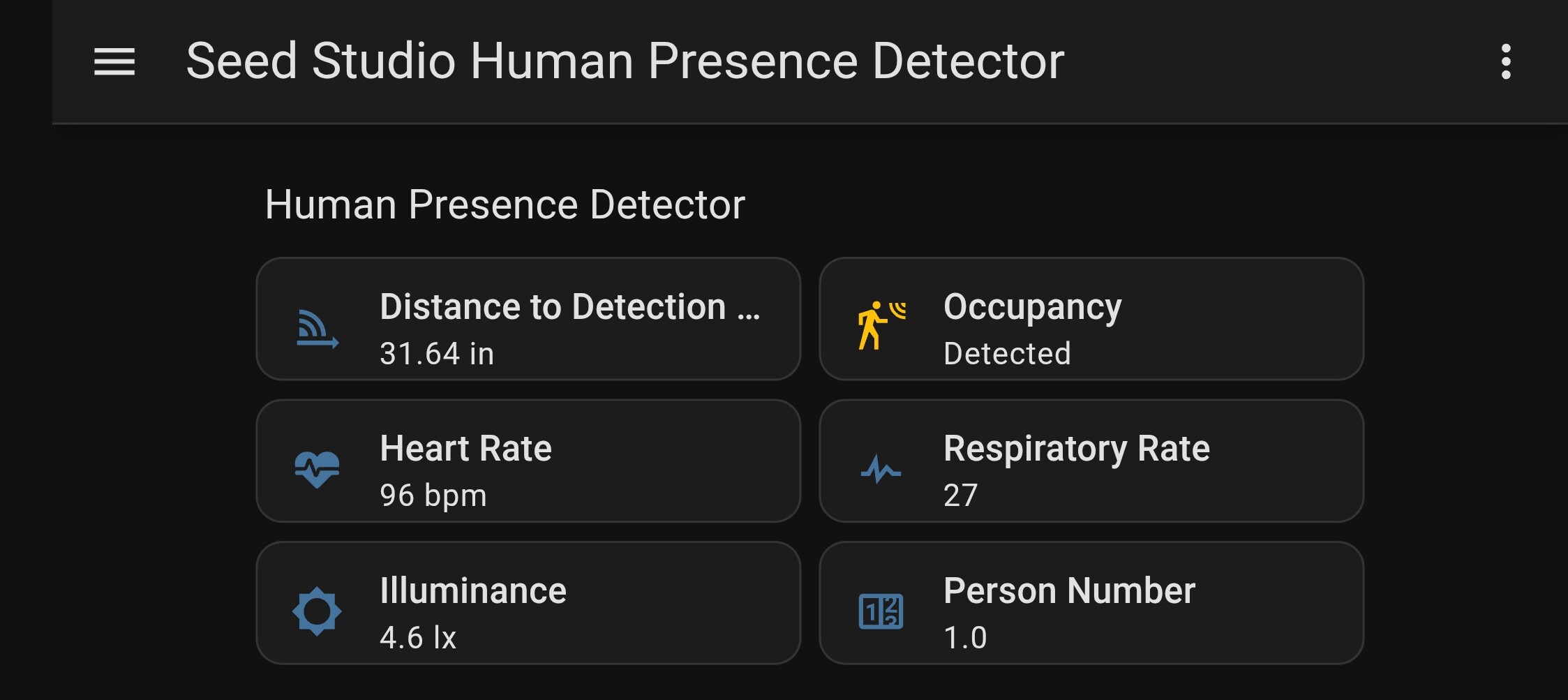

I am completely amazed. You connect it to your wifi network with your phone. Give it your SSID and password. Home Assistant found it with devices and services and added it immediately. It was ready to add to a dashboard and all the values were displayed in real time. It was tracking my heartbeat and breathing rate as I sat at my desk from about three feet away. Way beyond anything I was expecting.
The second picture in the post above is my Home Assistant dashboard showing my heart rate and breathing in real time.

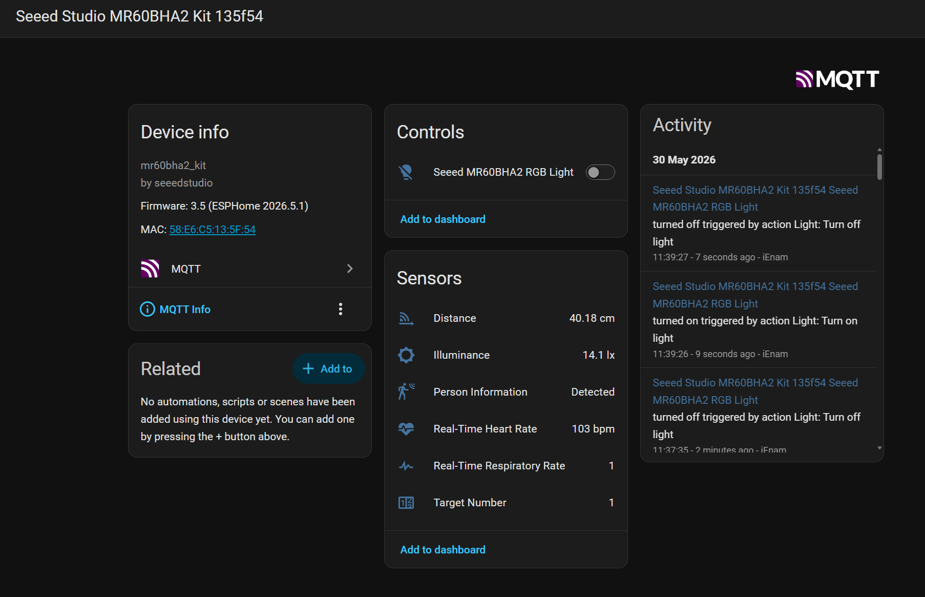

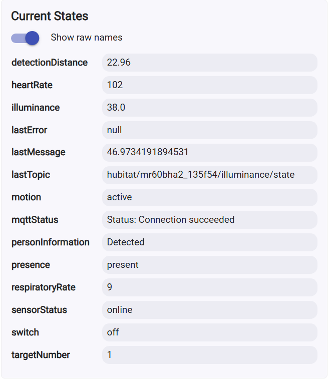

My sensor arrived today from Aliexpress :grinning_face:
First thing I did was to take to AI to write a code (ChatGPT first then Claude to get it working, then back to ChatGPT!), after several hours, I have managed to write a driver for Hubitat - working so far, but will need further testing.
My first impression of the sensor… it will not be replacing any of my other presence sensors, will do further tests to see how useful it will be!

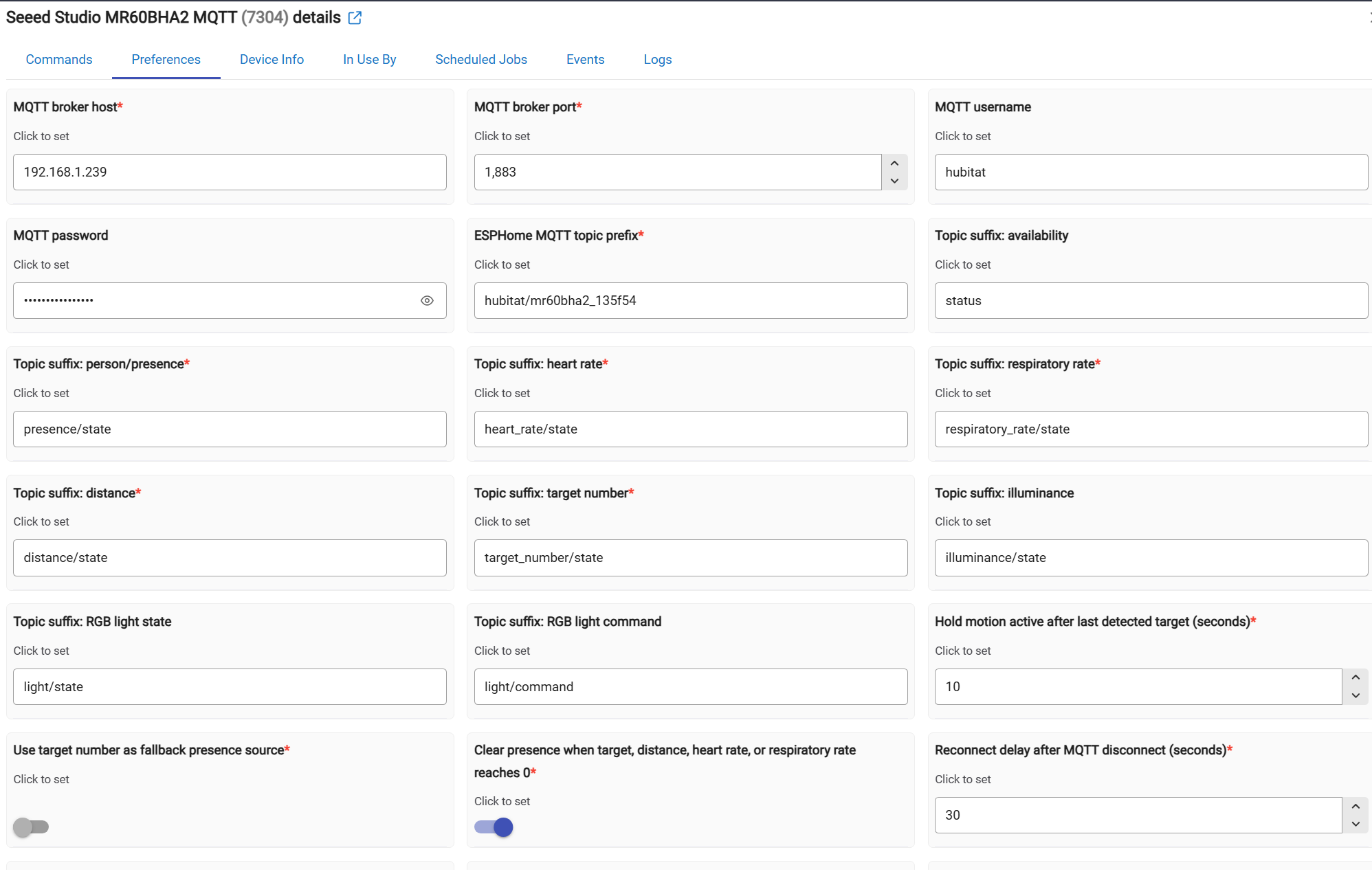

 * Seeed Studio MR60BHA2 MQTT Driver for Hubitat
 * Independent Hubitat driver that subscribes directly to MQTT topics from a
 * Seeed Studio MR60BHA2 60GHz mmWave ESPHome device. It does not require
 * Home Assistant.

        logDebug "Ignoring transient MQTT status after successful connect: ${statusText}"
        state.mqttConnected = false
        sendEventIfChanged([name: 'sensorStatus', value: 'offline', displayed: false])
        scheduleReconnect()
        return
    scheduleReconnect()
void parse(String description) {
    if (settings.traceMqttMessages == true) {
        logDebug "parse() called: ${description?.take(120)}"
    Map message
    try {
        message = interfaces.mqtt.parseMessage(description)
    } catch (Exception e) {
        recordError("MQTT message parse failed: ${e.message}")
        return
    String topic = message?.topic?.toString()
    String payload = message?.payload?.toString()
    if (!topic) {
        logDebug "Ignoring MQTT message without topic: ${description}"
        return
    handleTopic(topic, payload ?: '')
void on() {
    publishLightCommand(true)
void off() {
    publishLightCommand(false)
void publishTestCommand() {
    runIn(2, 'off')
void publishPresenceTest() {
    String topic = topicMap().presence
    try {
        logDebug "Publishing ON to ${topic}"
        interfaces.mqtt.publish(topic, 'on')
        recordError("MQTT presence test publish failed: ${e.message}")
void subscribeTopics() {
    if (settings.subscribeToPrefixWildcard != false) {
        // Wildcard covers all topics; do NOT also subscribe individually or every
        // message will be delivered twice (once per subscription), causing double
        // sendEvent() calls and erratic presence/motion timing
        String wildcard = "${normalisedPrefix()}/#"
        logDebug "Subscribing to wildcard ${wildcard} (individual topic subscriptions skipped)"
        interfaces.mqtt.subscribe(wildcard)
        return
    // Wildcard disabled; subscribe to each topic individually
    topicMap().each { String key, String topic ->
        if (topic && key != 'lightCommand') {
            logDebug "Subscribing to ${topic}"
            interfaces.mqtt.subscribe(topic)
private void handleTopic(String topic, String payload) {
    Map<String, String> topics = topicMap()
    if (isDuplicatePayload(topic, payload)) return
        logDebug "MQTT ${topic} = ${payload}"
    if (settings.diagnosticEvents == true) {
        sendEventIfChanged([name: 'lastTopic', value: topic.take(255), displayed: false])
        sendEventIfChanged([name: 'lastMessage', value: payload.take(255), displayed: false])
    if (topic == topics.availability) {
        String value = payload.trim().toLowerCase()
        sendEventIfChanged([name: 'sensorStatus', value: value == 'online' ? 'online' : 'offline'])
        return
    if (topic == topics.presence) {
        Boolean detected = asBoolean(payload)
        if (detected != null) {
            sendEventIfChanged([name: 'personInformation', value: detected ? 'Detected' : 'Clear'])
            updatePresence(detected, false)
            markOnline()
        return
    if (topic == topics.heartRate) {
        BigDecimal value = sendNumericEvent('heartRate', payload, 0, 'bpm')
        clearPresenceIfZero(value)
        markOnline()
        return
    if (topic == topics.breathRate) {
        BigDecimal value = sendNumericEvent('respiratoryRate', payload, 0, 'rpm')
        markOnline()
        return
    if (topic == topics.distance) {
        BigDecimal value = sendNumericEvent('detectionDistance', payload, 2, 'cm')
        markOnline()
        return
    if (topic == topics.targetNumber) {
        BigDecimal value = asDecimal(payload)
        if (value != null) {
            Integer targets = Math.max(0, value.intValue())
            sendEventIfChanged([name: 'targetNumber', value: targets])
            if (settings.targetNumberControlsPresence == true) {
                updatePresence(targets > 0, true)
            } else if (targets == 0 && settings.zeroValuesClearPresence != false) {
                updatePresence(false, false)
            markOnline()
        return
    if (topic == topics.illuminance) {
        sendNumericEvent('illuminance', payload, 1, 'lx')
        markOnline()
        return
    if (topic == topics.lightState) {
        Boolean isOn
        // ESPHome RGB lights publish JSON: {"state":"ON","brightness":255,...}
        // Handle both JSON and plain ON/OFF strings
        if (payload.trim().startsWith('{')) {
            try {
                Map json = new groovy.json.JsonSlurper().parseText(payload)
                isOn = asBoolean(json?.state)
                logDebug "Light state JSON parsed: state=${json?.state} -> isOn=${isOn}"
                logDebug "Light state JSON parse failed, falling back to raw: ${e.message}"
                isOn = asBoolean(payload)
        } else {
        if (isOn != null) {
            sendEventIfChanged([name: 'switch', value: isOn ? 'on' : 'off'])
            markOnline()
        } else {
            logDebug "Light state payload not recognised: ${payload}"
        return
    logDebug "Unhandled MQTT topic ${topic}"
private void publishLightCommand(Boolean turnOn) {
    String topic = topicMap().lightCommand
    if (!topic) {
        recordError('RGB light command topic is not configured')
        return
    String payload = turnOn ? 'ON' : 'OFF'
    try {
        logDebug "Publishing ${payload} to ${topic}"
        interfaces.mqtt.publish(topic, payload)
        sendEventIfChanged([name: 'switch', value: turnOn ? 'on' : 'off'])
        recordError("MQTT publish failed: ${e.message}")
private void updatePresence(Boolean detected, Boolean useTimeout = true) {
    if (detected) {
        unschedule('markNotPresent')
        state.lastDetectedAt = now()
        sendEventIfChanged([name: 'presence', value: 'present'])
        sendEventIfChanged([name: 'motion', value: 'active'])
        Integer hold = useTimeout ? safeInteger(settings.presenceHoldSeconds, 10) : 0
        if (hold > 0) runIn(hold, 'markNotPresent')
        return
    Long lastSeen = state.lastDetectedAt as Long
    if (hold > 0 && lastSeen) {
        Long elapsedMs = now() - lastSeen
        if (elapsedMs < hold * 1000L) {
            Integer remaining = Math.max(1, hold - Math.floor(elapsedMs / 1000D).intValue())
            runIn(remaining, 'markNotPresent')
            return
    markNotPresent()
void markNotPresent() {
    sendEventIfChanged([name: 'presence', value: 'not present'])
    sendEventIfChanged([name: 'motion', value: 'inactive'])
private BigDecimal sendNumericEvent(String attributeName, String payload, Integer scale, String unit) {
    if (value == null) return null
    BigDecimal rounded = value.setScale(scale, BigDecimal.ROUND_HALF_UP)
    sendEventIfChanged([name: attributeName, value: rounded, unit: unit])
    return rounded
private void clearPresenceIfZero(BigDecimal value) {
    if (settings.zeroValuesClearPresence == false || value == null) return
    if (value.compareTo(BigDecimal.ZERO) == 0) {
private void markOnline() {
    sendEventIfChanged([name: 'sensorStatus', value: 'online', displayed: false])
    clearError()
// Only fire sendEvent when the value has actually changed to avoid event spam
private void sendEventIfChanged(Map args) {
    if (device.currentValue(args.name)?.toString() != args.value?.toString()) {
        sendEvent(args)
private Boolean isDuplicatePayload(String topic, String payload) {
    Long nowMs = now()
    Integer windowMs = Math.max(0, safeInteger(settings.duplicateWindowMs, 1500))
    Map lastPayloads = (state.lastPayloadByTopic ?: [:]) as Map
    Map lastTimes = (state.lastPayloadAtByTopic ?: [:]) as Map
    String lastPayload = lastPayloads[topic]?.toString()
    Long lastAt = lastTimes[topic] as Long
    lastPayloads[topic] = payload
    lastTimes[topic] = nowMs
    state.lastPayloadByTopic = lastPayloads
    state.lastPayloadAtByTopic = lastTimes
    return windowMs > 0 && lastPayload == payload && lastAt != null && (nowMs - lastAt) < windowMs
private void scheduleReconnect() {
    Integer seconds = Math.max(5, safeInteger(settings.reconnectSeconds, 30))
    runIn(seconds, 'connect')
private Map<String, String> topicMap() {
    return [
        availability: fullTopic(settings.availabilityTopic ?: DEFAULT_TOPIC_SUFFIXES.availability),
        presence: fullTopic(settings.presenceTopic ?: DEFAULT_TOPIC_SUFFIXES.presence),
        heartRate: fullTopic(settings.heartRateTopic ?: DEFAULT_TOPIC_SUFFIXES.heartRate),
        breathRate: fullTopic(settings.breathRateTopic ?: DEFAULT_TOPIC_SUFFIXES.breathRate),
        distance: fullTopic(settings.distanceTopic ?: DEFAULT_TOPIC_SUFFIXES.distance),
        targetNumber: fullTopic(settings.targetNumberTopic ?: DEFAULT_TOPIC_SUFFIXES.targetNumber),
        illuminance: fullTopic(settings.illuminanceTopic ?: DEFAULT_TOPIC_SUFFIXES.illuminance),
        lightState: fullTopic(settings.lightStateTopic ?: DEFAULT_TOPIC_SUFFIXES.lightState),
        lightCommand: fullTopic(settings.lightCommandTopic ?: DEFAULT_TOPIC_SUFFIXES.lightCommand)
private String fullTopic(Object suffixValue) {
    String suffix = (suffixValue ?: '').toString().trim()
    if (!suffix) return ''
    suffix = suffix.replaceFirst(/^\/+/, '')
    String prefix = normalisedPrefix()
    if (!prefix || suffix.startsWith("${prefix}/")) return suffix
    return "${prefix}/${suffix}"
private String normalisedPrefix() {
    String prefix = (settings.topicPrefix ?: DEFAULT_TOPIC_PREFIX).toString().trim()
    return prefix.replaceFirst(/^\/+/, '').replaceFirst(/\/+$/, '')
private BigDecimal asDecimal(Object value) {
    try {
        if (value instanceof Number) return new BigDecimal(value.toString())
        String cleaned = value.toString().replaceAll(/[^0-9.\-]/, '')
        if (!cleaned) return null
        return new BigDecimal(cleaned)
    } catch (Exception ignored) {
        return null
private Boolean asBoolean(Object value) {
    if (value instanceof Boolean) return value
    if (value instanceof Number) return ((Number) value).intValue() != 0
    String text = value.toString().trim().toLowerCase()
    if (['true', 'on', 'yes', '1', 'detected', 'present', 'active', 'online'].contains(text)) return true
    // Added: 'none','no one','nobody','undetected' are ESPHome mmWave cleared-presence values
    if (['false', 'off', 'no', '0', 'clear', 'not detected', 'not present', 'inactive', 'offline',
         'none', 'no one', 'nobody', 'undetected'].contains(text)) return false
    return null
private Integer safeInteger(Object value, Integer fallback) {
    if (value == null) return fallback
    try {
        Integer parsed = value as Integer
        return parsed == null ? fallback : parsed
        return fallback
private void recordError(String message) {
    log.warn message
    sendEventIfChanged([name: 'lastError', value: message.take(255), displayed: false])
private void clearError() {
    if (device.currentValue('lastError')) {
        sendEventIfChanged([name: 'lastError', value: '', displayed: false])
private void logInfo(String message) {
    if (settings.logEnable != false) log.info message
private void logDebug(String message) {
    if (settings.debugEnable == true) log.debug message

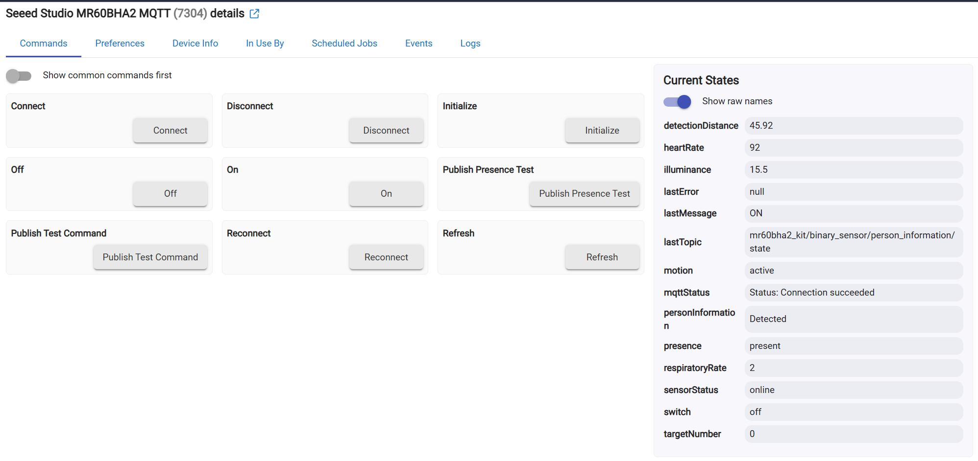

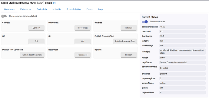

Note: the above driver is still dependent on Home Assistant which is acting as a bridge … will need to reflash with ESPHome YAML to break free from HA … I might do it as I have been slowly moving everything from HA :sweat_smile:
Done it, free from HA! :grinning_face:
Will update details, including updated code later…

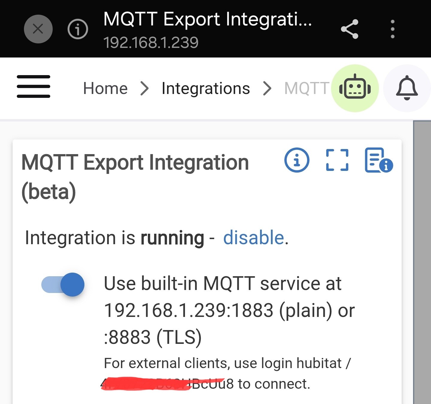

Stupid question: Is MQTT local in this case?
Yes, it's fully local. The MQTT broker is Hubitat's built-in MQTT integration running on Local LAN.
ESPHome publishes sensor data to Hubitat (I had to programme ESPHome to do that from HA).
The Hubitat driver subscribes directly to that same local broker.
