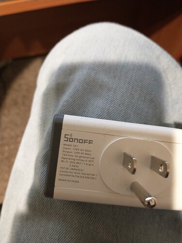

Recently received a box labeled Sonoff Zigbee. I even have pictures around here somewhere - the box was labeled Zigbee but I couldn't get anything from the units - and when I took a maginifying glass (I'm old) and looked at the label on the side of the device it was clearly marked 'WiFi 2.4'. This confuses a lot of people since Zigbee and Wifi work in the 2.4Ghz band and the chinese haven't learned how to clearly demarc this.
The vendor was very happy to swap and replace - and that was my fix. I suspect you've been bit by this confusion...
** found one pic - this came in a Zigbee box
