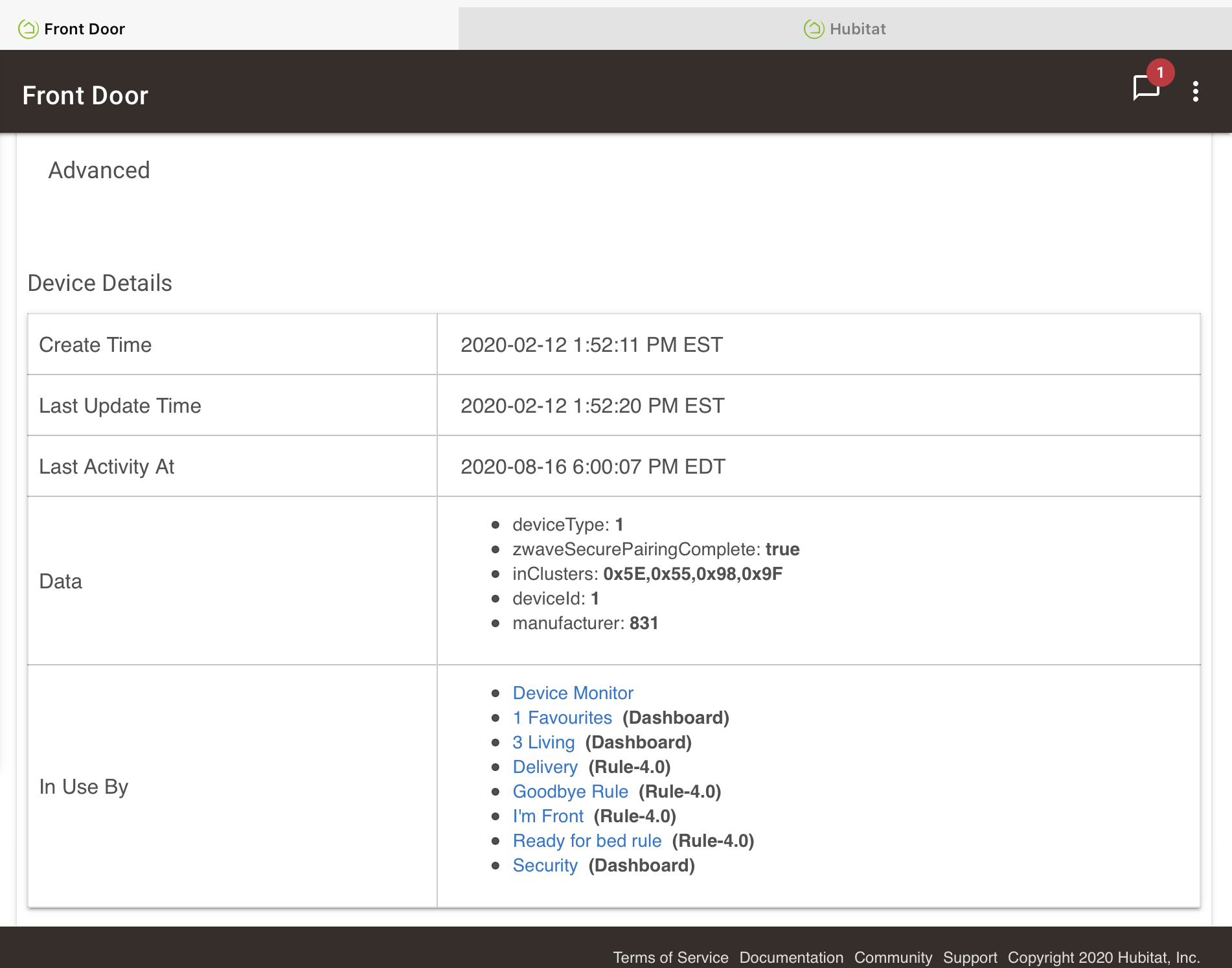

Now my front door (August lock via ZWave) is randomly unlocking. It appears to be triggered either when a contact sensor open, or when a Lutron switch turns on (which is linked to the contact sensor via an automation) but again, not every time. Managed to copy the log, any clue what’s going on here??

That’s the odd thing - ā€˜Front Door’ isn’t in a lot. Total of 3 dashboards, 3 rules that are only manually triggered (ready for bed, goodbye & I’m front), 1 rule that is a condition, and then Device Monitor ...
