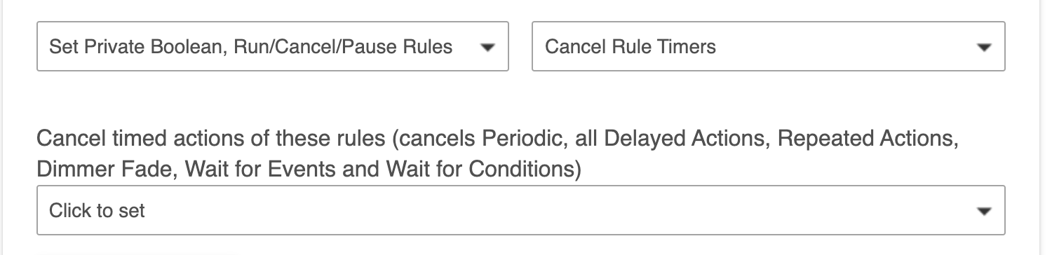

Under which Action category is 'Stop Rule Actions'? I can't even find it :confused:
@bravenel Has 'Stop Rule Actions' been removed or renamed?
Should be under 'Run/Cancel/Pause Rules'?
I'd like to send an 'stop and exit' command to one rule from another.
There never was such an action. There is Cancel Rule Timers, which before had a different name. Cancel Rule Timers does stop an in progress Repeat. There is no way to cause another rule to exit.
Then why is it listed in the Rule-4.0 documentation?
That is the action that was renamed to Cancel Rule Timers. It was renamed because what it did was the same thing as Cancel Rule Timers, and the name was misleading. All it ever did was stop the same things shown above.
