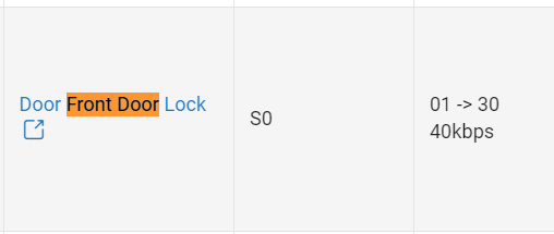

I have a BE469NX and it is definitely S0:
I can validate. Can you tell me where to pickup a new electronics package?
Typically they were found on eBay, in the form of either used working locks for sale, or in used broken locks where the PCB was still functional. Used to be cheap and not too hard to find, lately I've heard much harder to find, or more expensive.
