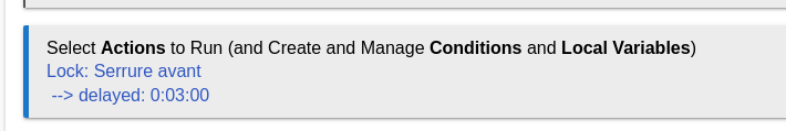

Based on this, I guess I'd just trash the existing rule and build it as new again. Maybe a long shot, but might work.
Why the If statement? No matter what, you want it locked after 3 minutes.
And why delay the rule instead of delaying the lock command ?
Maybe try that to see if the problem still occurs.
I think the problem might be a missing Cancel Delayed Actions as your first action, as every unlock event within that 3 minute period will re-trigger the rule and create a new instance of the rule with another 3 minute delay
Alternatively change your delay for a Wait for Event - elapsed time. That will get cancelled upon rule retriggering.
Best if you turn on full logging (triggers, events, actions) to see what is going on
The reasoning for this was to save battery and machine part wear as the state of the lock (locked/unlock) is always correct.
Thank you for the suggestion, I have the same problem regardless of where I put the delay.
Thank you for the reply. Full logging has been on since I've been troubleshooting this problem.
