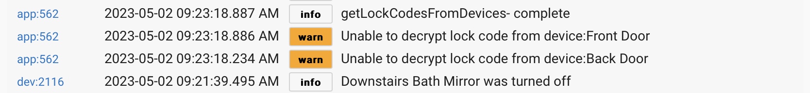

Now, I do occasionally get the line 522 error on (Edit:) built-in Schlage lock driver after migration to C-8 (never saw it on C-7). If I open Lock Code Manager, it reports unable to decode lock codes, and the log no longer reports whose code did the unlocking, but I treat it as innocuous, doesn’t seem to affect operation.

disable encryption on the lock then click the configure command, it should then re-read the codes off of the lock.
you can then re-enable encryption.

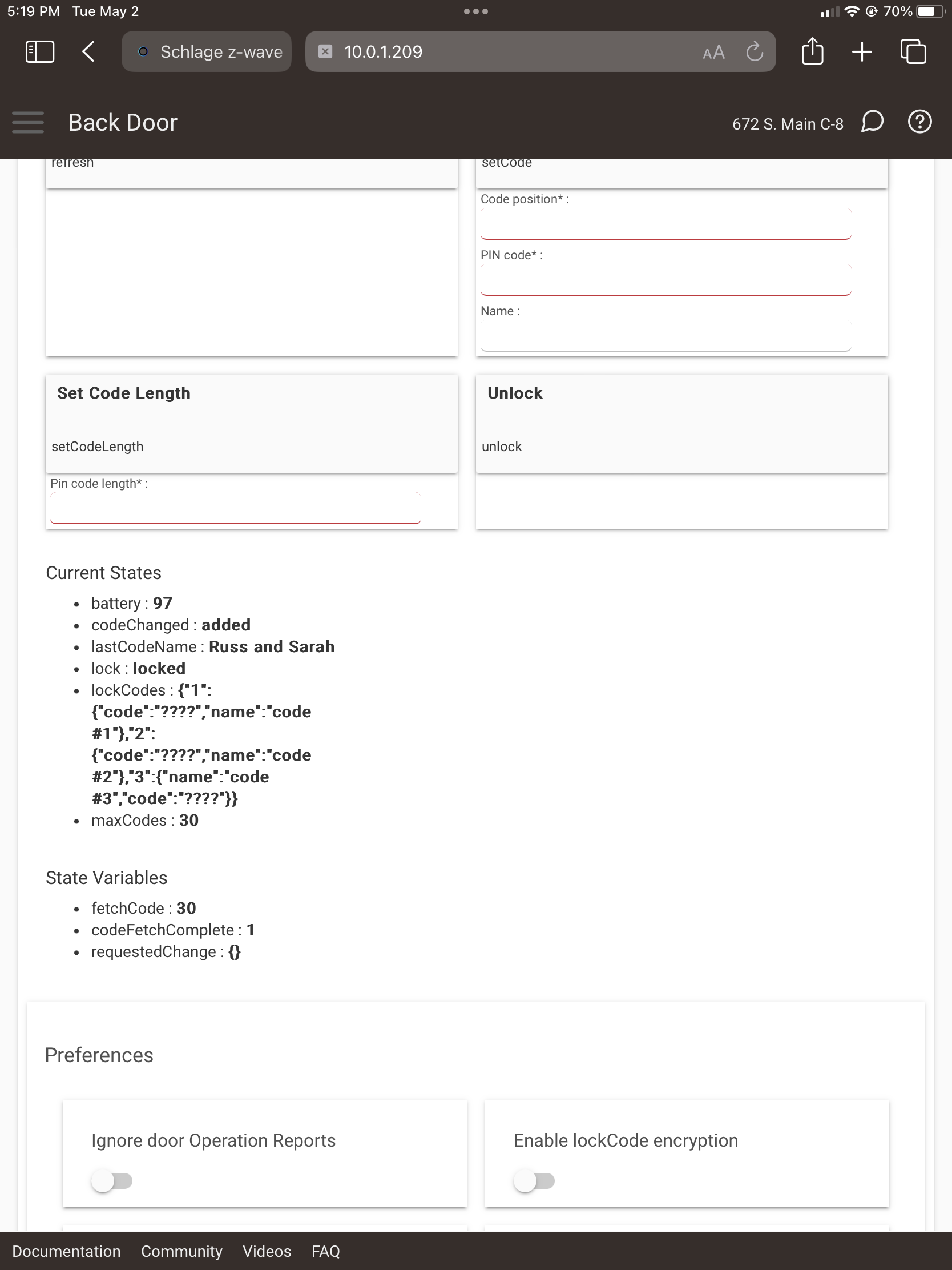

I migrated from C7 to C8 with a backup. C8 can see the Status when manually locked but not with locking/ unlocking electronically, using codes, or pressing Schlage symbol to lock. It can be controlled with Hubitat. After reading on, I disabled encryption, at lock deleted all codes, and used LCM to send codes. The job failed. Haven't given up. Still trying different ideas...
OK. A mistake on my part for the disabling the encryption before putting in codes. When I disabled the encryption, I did not save and then hit configure. After the first try without saving I noticed the encryption was still there. With encryption disabled codes were added to lock using LMC with no issues. Status of lock is updates as normal. Turning off the encryption was the fix! Thanks to all for the help! Couldn't have fixed it without the help.
Well, only way I was able to fix it was to delete the 3 users and codes, re-add the 3 users and codes, configure, enable encryption for both locks.
