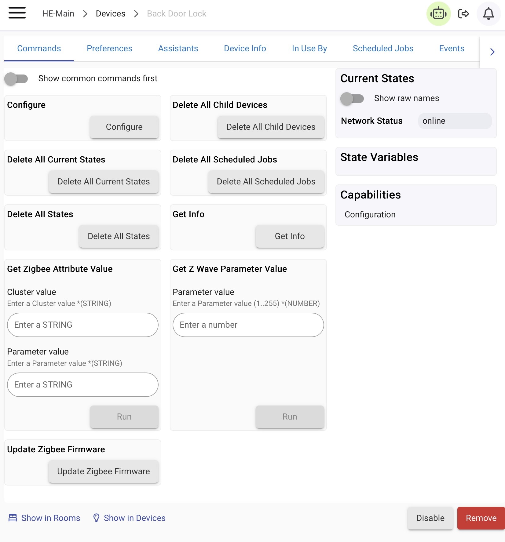

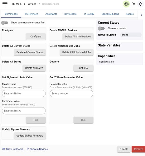

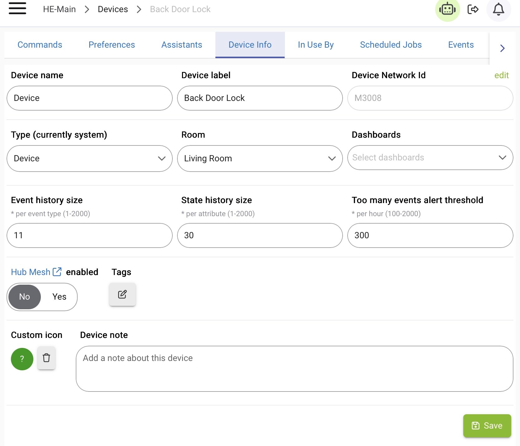

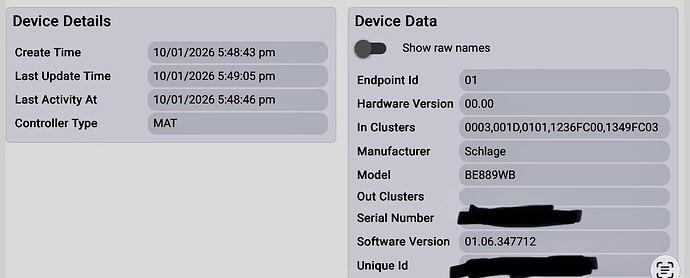

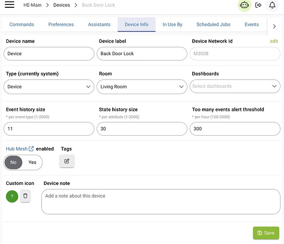

I purchased a Schlage Sense Pro. I added it to Apple Home and finally got it threaded paired with Hubitat. In the device on Hubitat it shows up as “device” and doesn’t even have the lock and unlock functionality. Am I doing something wrong?

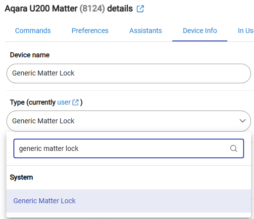

Change the device type to "Generic Matter Lock", then click on the Initialize button :
You should be able to lock and unlock the Schlage Sense Pro. If you operate it from Apple Home, the locked/unlocked status should be updated in Hubitat as well.

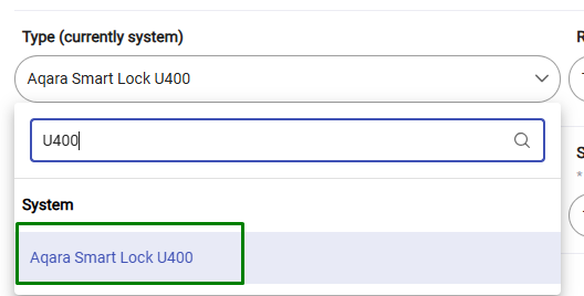

You can also try the inbuilt 'Aqara Smart Lock U400' driver :
Thanks for the idea! I will try U400 driver and see if battery is reported. Generic driver does not report battery % and I get 'unhandled attribute report' in logs.
