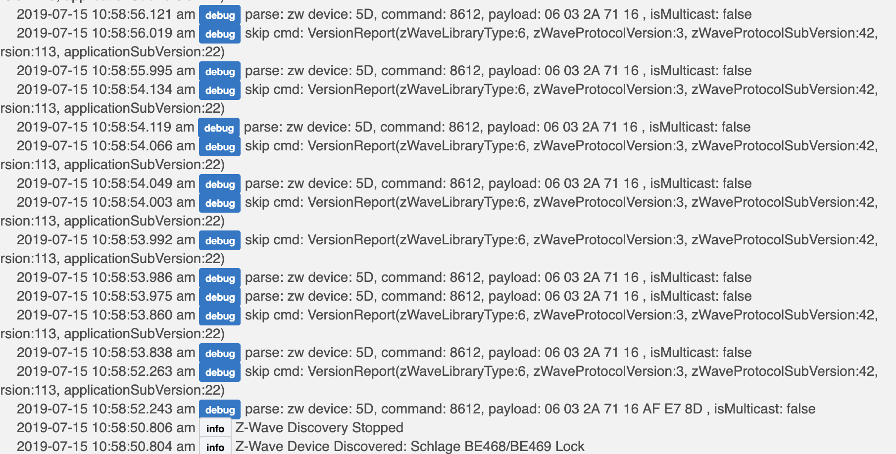

So I'm attempting to pair a Schlage BE468 with little luck. I have a total of 4 of these and two have paired just fine while two others refuse to pair. Here is a list of things I've done to troubleshoot as well as a screenshot from my logs.
  • Checked for hub updates
  • Rebooted hub
  • Moved hub within 2 feet of the lock
  • Ran z-wave exclusion
  • Replaced the batteries in the lock with fresh ones
  • Ran a z-wave repair
Any suggestions?

Tried that as well. :slight_smile: Just updated my original troubleshooting list.

Thanks for the encouragement! After completing the exclusion and inclusion process 16 times (yes, 16...I counted) it successfully paired. No freakin' clue as to why it finally decided to work. The kicker... I went to move over my last lock and it paired on the first go...
