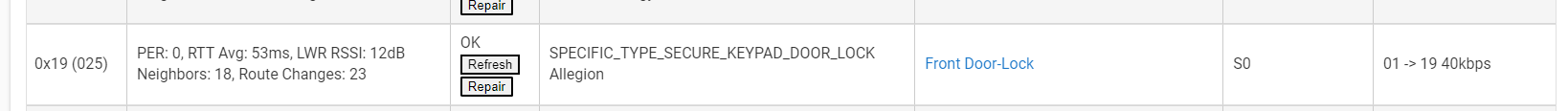

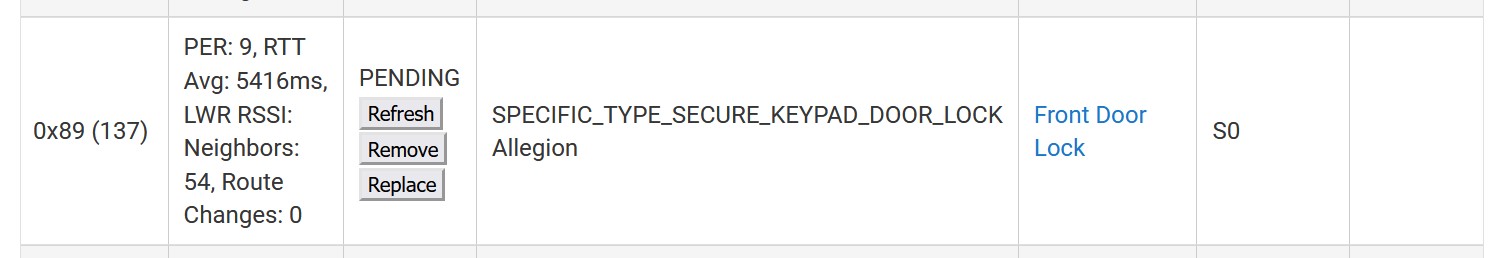

seems like the front door locks fell off the network for some reason.

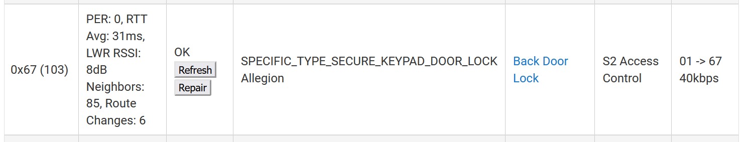

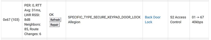

The back door lock seems now connected but now respond only to logical commands but not updating the hub when physical lock/unlock happens.

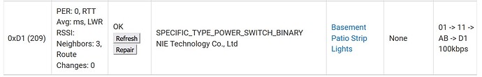

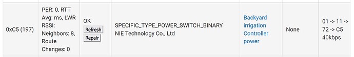

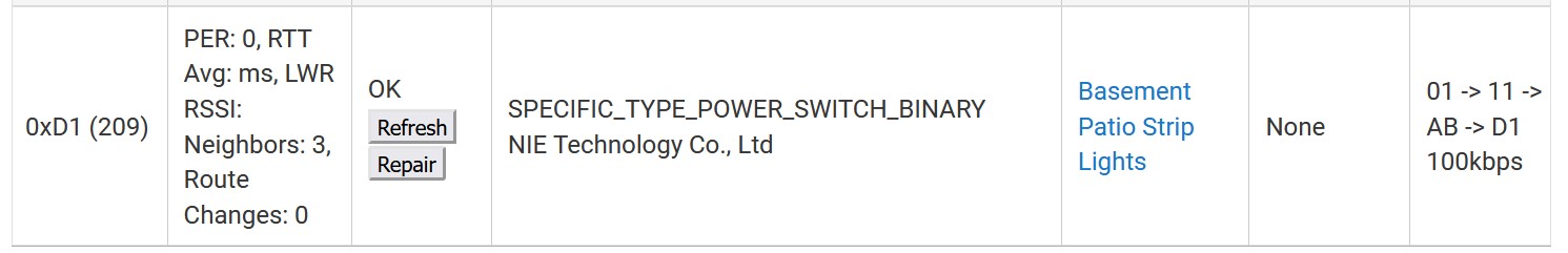

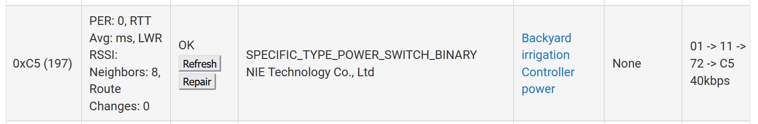

Can you post your whole z-wave table?
