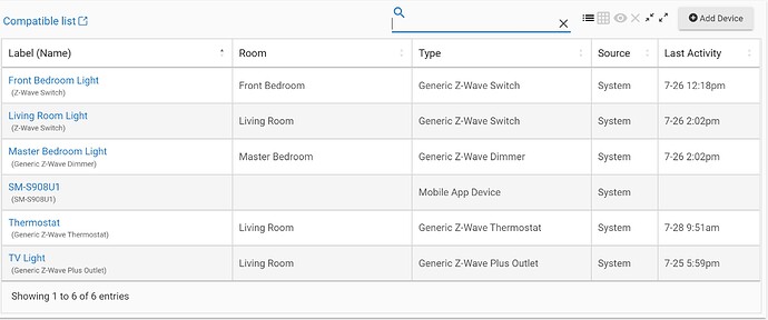

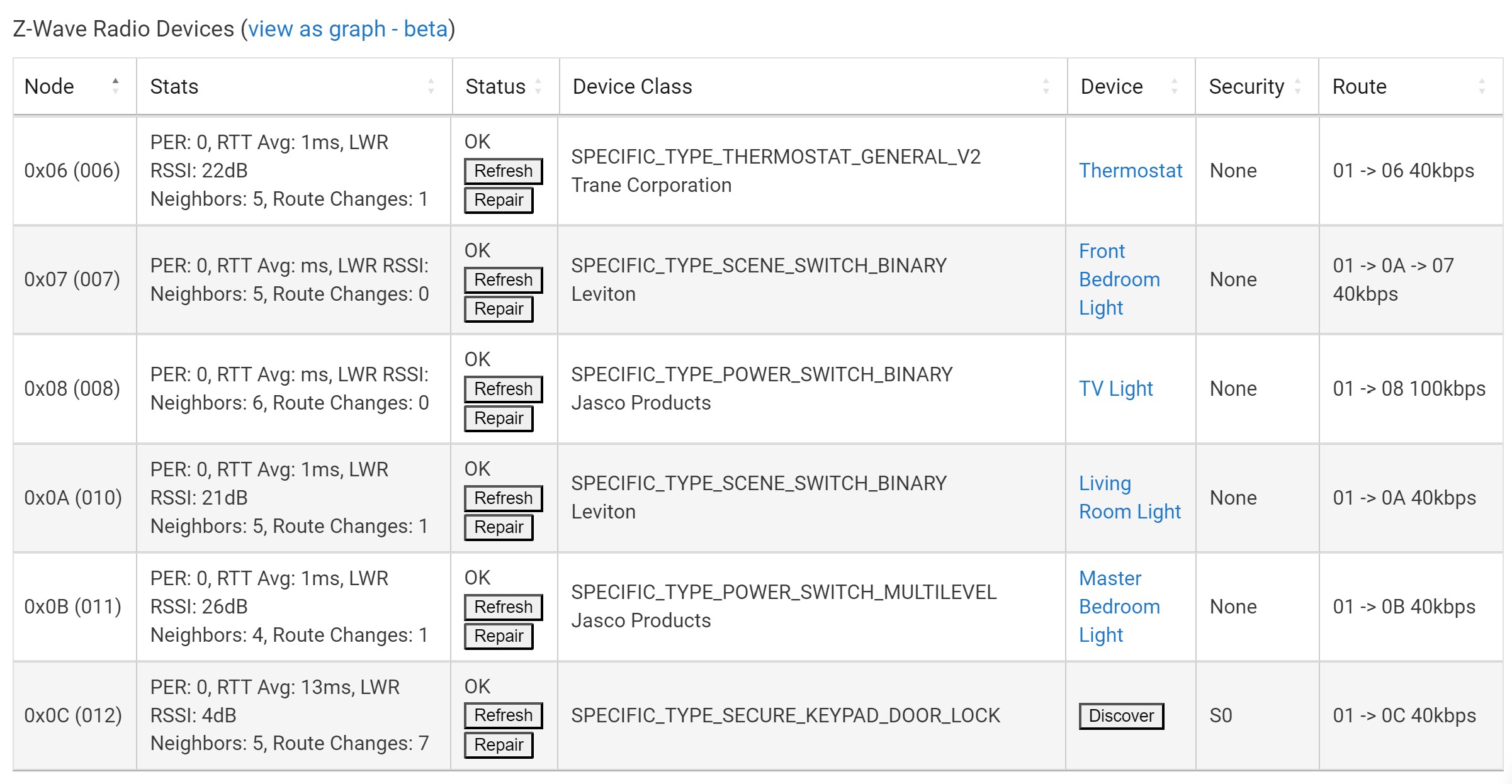

To start, I am not even sure there is a ghost? Because from what I understand the "Route" would be blank? I have tried excluding it, reset the lock to default, placed the hub within 6 inches. No luck! Yeah, I've also hit the "Discover" button multiple times. Waited several days and repeated no luck...also hit refresh and repair...

Your lock seems to not be getting a very good signal. RSSI (signal strength) is very low at 4db. There are lots of route changes, and very few neighbors.
In general, I think you have a lack of enough repeating devices to form a strong mesh. Maybe more specifically, you don't have a repeating device close enough to this lock or between the lock and hub that will help to strengthen the mesh. The Schlage like having repeaters.
It is fairly typical to not have a strong mesh when you only have a few devices, it seems like it takes about 10-12 repeating devices to achieve "critical mass" so to say, but it depends upon the environment.
You don't say how large the house is, or how spread apart things are, or whether you have a challenging situation like lots of metal air ducts between the hub and lock, cement block walls, large mirrors, or something like wire mesh plaster that which are all good at killing signals. Those situations for sure require some thought to get stability and reliability in the mesh.
@user6235 You have created a ghost with the lock., It needs to be removed.
Next you need to make sure that your lock has firmware 7.10 or above (look on the plate with your original codes. You will have to pull the knob side). Anything below this is a crap shoot. Next You need to pair the lock within 2-3 feet of the hub due to the whisper encryption exchange this lock uses. Once done you should be good. Though as @neonturbo mentioned, using a beaming repeater nearby helps after all is said and done.
