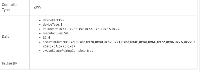

After doing all of the above, and adding lock as Generic Z Wave, the lock is immediately seen, pairs, then asks if we want to pair with security, I say yes, enter the DSK code, and again it immediately responds, pairs, flashes that it's happy, asks me to name the device, door beeps, and then it appears in devices... so it SEEMS like the pairing is happening smoothly - all of the above is fast and with no issues.
But, after the above, the lock appears in HE as simply "Device"... I can change it to either Generic Z-Wave lock and save, and/or to the Schlage 469 Lock drier and save.

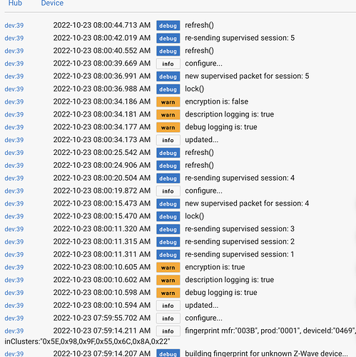

The problem is that after this successful pairing, the lock doesn't respond to anything. I can hit 'configure', 'lock', etc - and live LOGS show it sending the command, but lock doesn't respond to any request to HE. One one of the pairings it did report a 100% battery, but still didn't respond to configure, lock, etc...
What am I doing wrong? Attaching screenshots showing it's paired, and the logs.

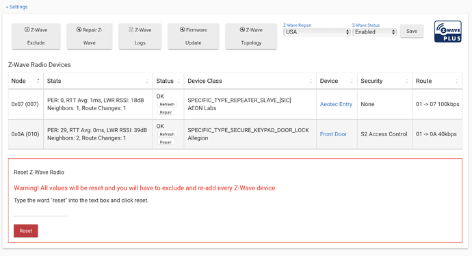

Hubitat will force you to pair all locks with security and you want it to. Can you post a copy of your z-wave details page in it's entirety?

Sure here are Wave Details. As you can see this is a brand new HE setup, as we are now retiring ST and moving to HE, and this is the very first item we'd like to add. I have an Aeotec 6 Extender added. I've tried to do the lock pair with the aeotec added as a device and without it, and both ways, the lock still does the same thing - it pairs immediately then won't respond to the HE.

Ok, trying that now. Fingers crossed. Have spent 4 hours on just this lock including, excluding, moving, power cycles, etc. I don't understand why it will pair, include/exclude without issue (seems that's usually what people have problems with), but then just won't respond to HE after that at all. Logs show requests, but lock never responds to them. Is it not fully pairing even though it says it is? Firmware updating now...
