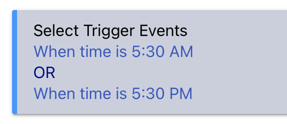

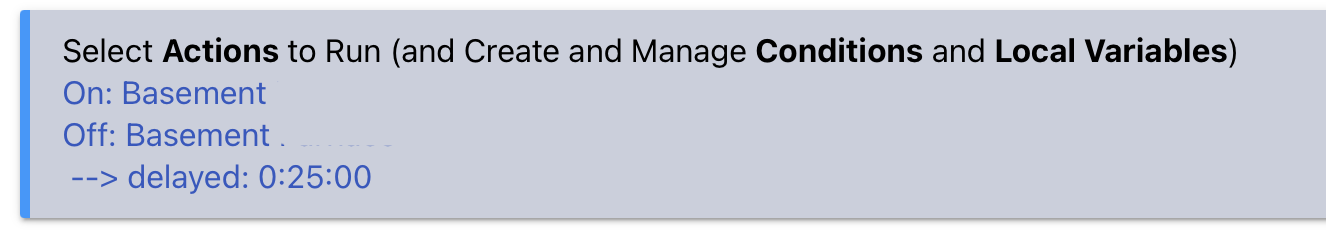

I have this rule. The problem is it does not turn on at the scheduled time and it does not stay on for the scheduled duration.

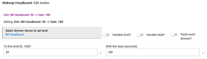

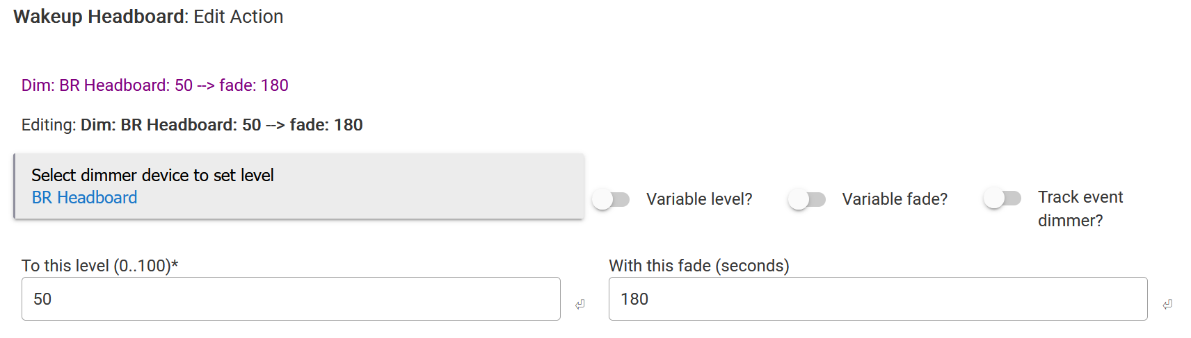

Let me add one more wrinkle. On the two lights, I use the fade function to have the lights (one is directly above my eyes) slowly brighten to 50% over 3 minutes...sweet. See the screenshot.
I do have the trigger set to 2 times a day. the issue isnt that the trigger is not firing. the trigger does fire according to the logs but the action doesnt always happen immediately.
In my logs above you can see the trigger happened at 5:30 but the action didnt happen until 6:05
