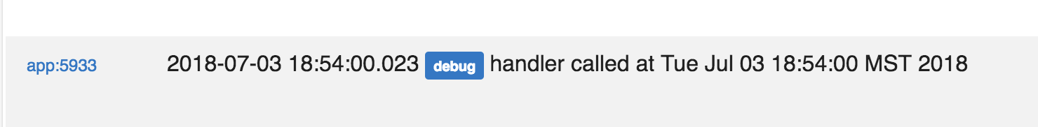

I'm not able to reproduce an error with this exact code. But, I notice in your case that the code says 'theTime', and the error says 'theTiime1'. Could that be your problem?
definition(
    namespace: "bravenel",
    author: "Bruce Ravenel",
    description: "test time",
    category: "My Apps",
    iconUrl: "",
    iconX2Url: "",
    iconX3Url: "")
preferences {
    section {
    	input "theTime", "time", title: "Time to execute every day"
def initialize() {
    schedule(theTime, handler)
// called every day at the time specified by the user
def handler() {
    log.debug "handler called at ${new Date()}"
def installed() {
    initialize()
def updated() {
    initialize()
