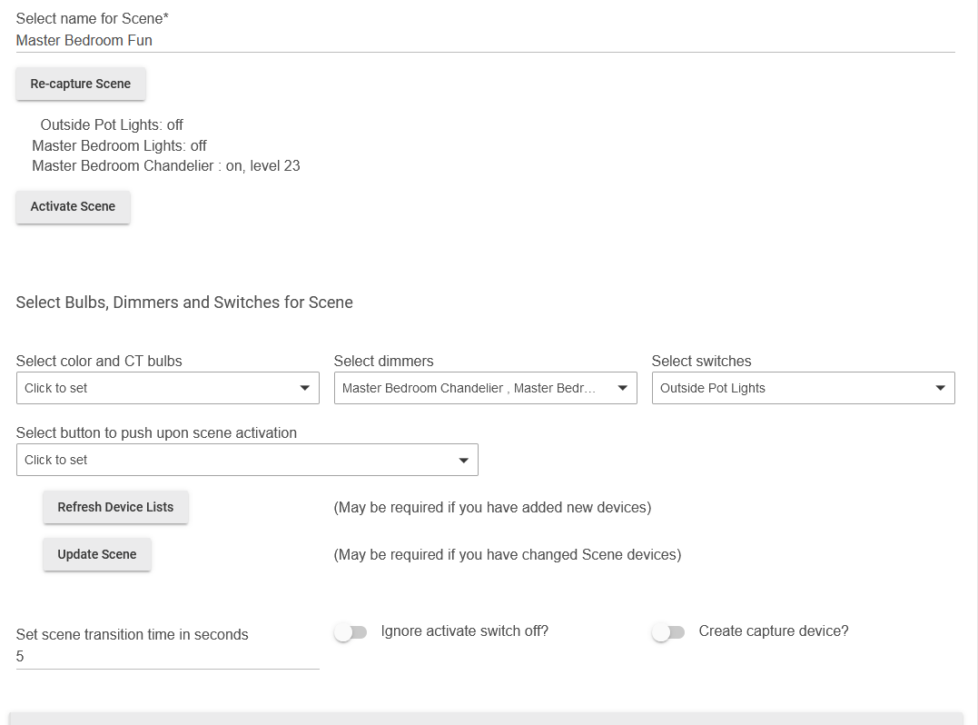

I am trying to setup a rule to create and action of activating a scene. When I follow through the prompts of rule machine, I get to the point of selecting which scene I want to activate. The problem I am having is that it does not list the 2 scenes I have built - only one. Any thoughts on this? I have included screen shots below to show that I have 2 scenes and a screen shot to show that only one is showing up.

Hmmm seems like it should work. Can you perhaps post screen shots of the two scenes? Or are there devices associated with "master bedroom fun" that are not suitable for a family forum Also check your "devices" tab to see if both of those scenes made it to the list and properly show up as "scene activators."

Open each Scene and hit Done. Then look at that again. You can see there are no registeredScenes. That's where the info comes from. Show your Apps list for Groups and Scenes.
I have gone into each of them and hit done - nothing seems to have changed. I have used those scenes multiple times from my dashboard so I know they work from there
AH, I went back into it again for a second time and hit done, and now they are showing in the drop down. What changed?
If I had already been using those scenes from my dashboard, I would have had to have already hit done before - so why is me doing that 2 more times making it work?
