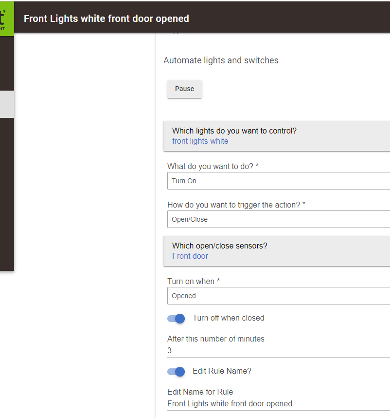

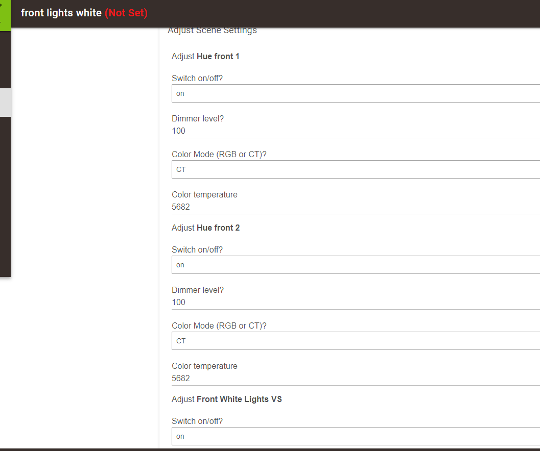

So I have 2 bulbs at the front of my house, and when the front door opens I have a scene to turn those 2 bulbs on. Here is the scene and the settings..

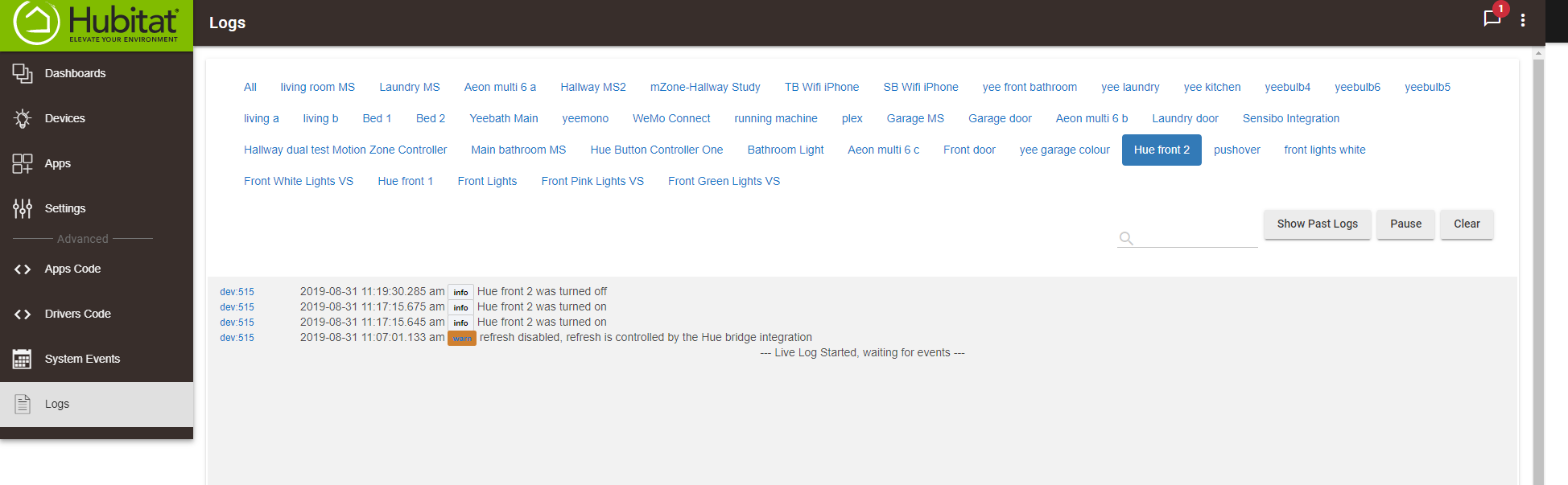

I activated the scene with logging on. After 4 minutes the RM3 turned the 2 bulbs off. This is what the log shows.
also - for some reason one bulb was turned off a minute before the other :man_facepalming:

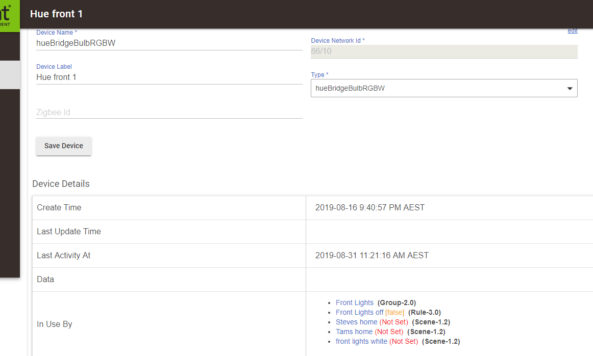

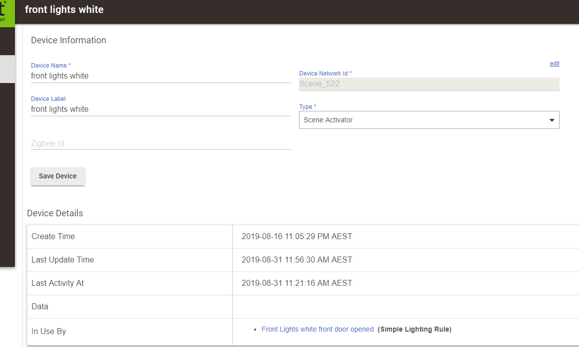

Are you sure there's no other app/automation that might be turning these off after you turn them on? (Like Bruce, I'm a bit confused about the problem--it seems to be the things that happen a few minutes after this scene is activated, which could easily be caused by something else.) What does the "In use by" section on the problematic device look like? If any of those are Rule Machine children, enable logging on those to be sure they're not running (in which case you'll see them in the live or past logs, which will help pinpoint or eliminate these as a possible problem)--same for any app you can enable logging on that these devices use.

The scene is in use by one simple lighting rule, and yep - I can see now it has an off of 3 minutes which I should remove and leave the RM3 to do the power off cycle.
But from my post above, the light was turned off 2 minutes and 15 seconds after it was turned on.
The bulb is only in use by the 3 different colour scenes, the contact rule and the RM3 to turn them off after 4 minutes.

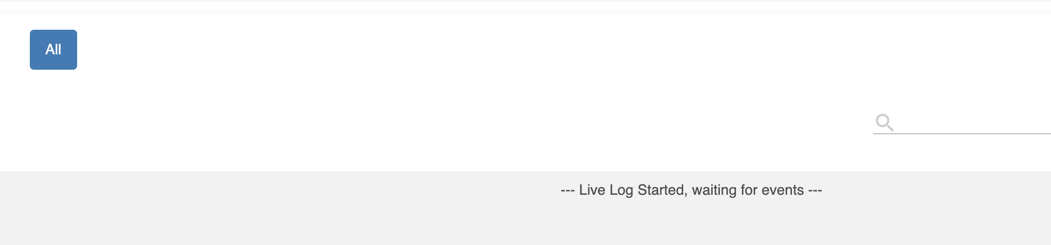

Bruce, I dont think you are actually reading my replies or looking at the screenshots.
I gave you exactly what you asked for and all that showed up In a NEW LOG was one entry. AKA what I replied with. Its what you're asking for, I already sent it.
https://community.hubitat.com/uploads/default/original/3X/c/b/cbaaf4a25829cc8ee433001ee1604f437e3c2927.png
Asking me to "learn how to send a screenshot" VS copy pasting the log where there is nothing else to see, and in the same post i've sent screenshots was probably the "mean" part.
I've sent pretty much every screenshot for everything to do with the scene and its activities above.

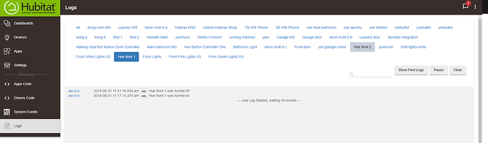

Here is the contact sensor log page:

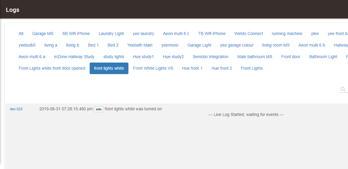

Here is the scene activator log page:
Here is the simple lighting log page:

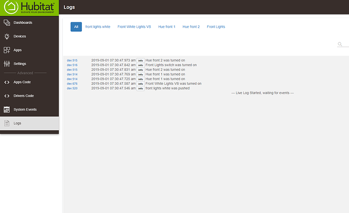

None of those are blank log pages, so it's not possible to see everything together affected by the action. And yes, I am not looking at what you've provided as it is too difficult.
You get a blank log pages by either clicking on Logs on the left or refreshing the page.
i'll get the contact one tonight as its set to fire at night.

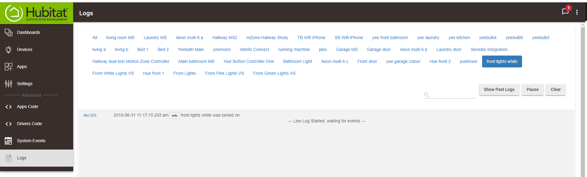

Scene activator, new log page
It looks like it did exactly what it was supposed to do. Do you see some problem with these logs?
