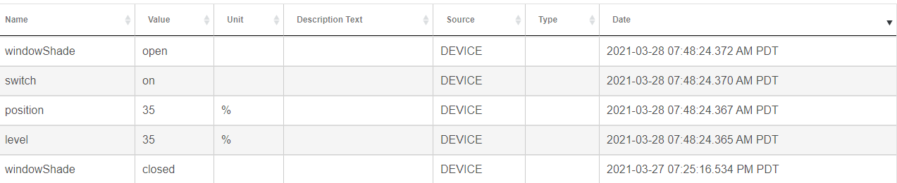

The three blinds that didn't open show no events when the scene was activated at 6:47 (sunrise 6:42 + 5 minutes). For example, event log below for one of the three blinds that didn't open below - all three blinds that didn't open show no events at or around the opening time:

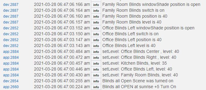

Logs show that SAR ran (Blinds all open at sunrise +5), the scene was turned on (Blinds alll open scene was turned on), and setLevel commands were sent for all five blinds, but only two seemed to get the commands:

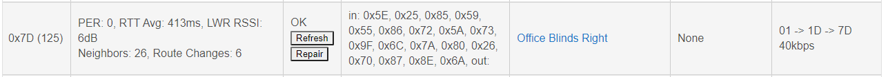

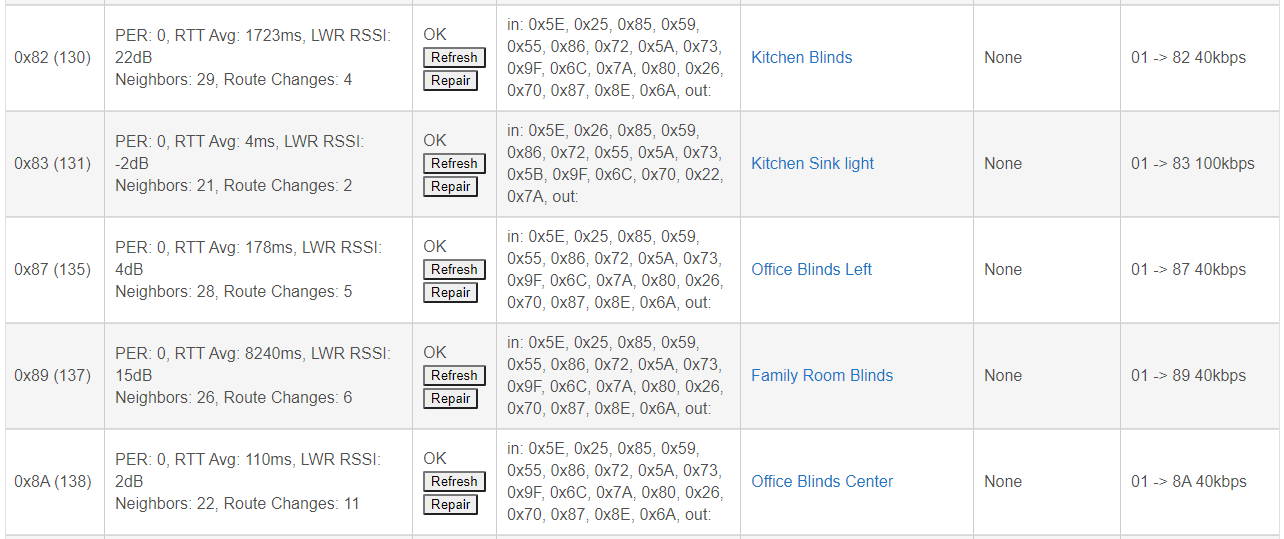

Z-Wave details is clean, no ghosts, no changes to Z-Wave devices, all are connected to power and reporting normal routing, four of the five connect direct to the hub, one routes through one node, all connect at 40k.

This isn't surprising if it didn't work. Events, generally speaking, don't show when commands were sent, only when a report is received from the device they something actually changed. (Technically, that's up to the driver, but pretty much all Z-Wave and Zigbee drivers work like this; iBlinds' custom driver, which I don't like for a variety of reasons, is an exception that "optimistically" generates events.) If you're using my driver, it will print a debug log when a command is sent if those are enabled. Lots of drivers don't do that either, though. However, the Scene app logs suggest they were sent.
So that still leaves the question of why: my guess is just a temporary problem with the device. As you know, I habe a lot of these, both v2 and v3, and have used them with both a C-7 and earlier hub model. Every once in a while, I have one that just doesn't respond. Trying again even a few minutes later usually works. Luckily, all of mine seem to be fine lately, but when they don't work, I've always had a hard time figuring out why (mesh issues? device/firmware/wakeup bug?).

My issues surface in long delays and non-responsiveness. At times, it's almost like the hub's radio isn't listening or transmitting for periods. Using a protocol monitor, I tend to see routing errors during those times.
Given the nature of zwp, problems can explode exponentially. If a packet doesn't get ACK'd, the device will resend it and start a semi panicky attempt to reach the destination by chatting up all it's neighbors. Once that happens to a few devices, you can imagine the traffic. That's kinda my gut feel about things--something goes south, then things explode until everything settles down again.
