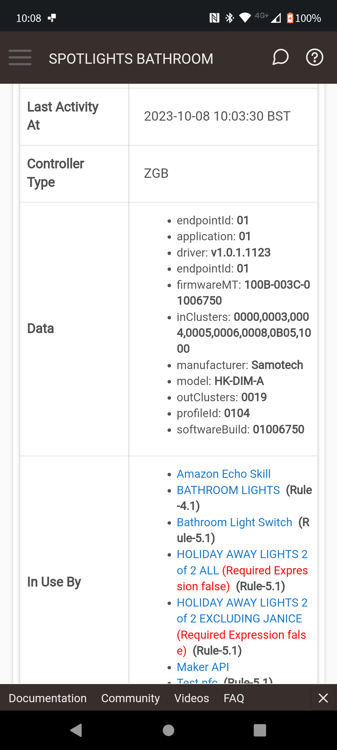

Can you post the device model, manufacturer and application version as shown on the HE device details section?
Hi @kkossev thanks for taking the time to look at this for me. Yes, this is the device in question. Here's the details as requested. :crossed_fingers:

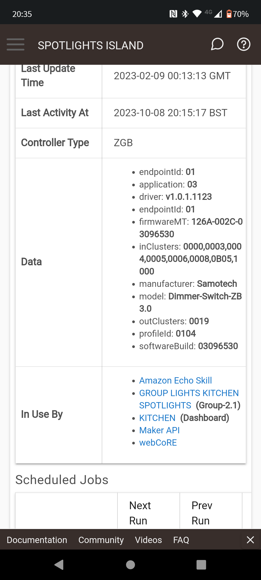

@kkossev, I have another 4 of these which I bought and installed last year. None of these suffer from this issue. When I've looked closer, they have a different model number and also a different firmware. I assume this is the issue. It seems odd that a newer version works in a less effective manner. Is there any way I can repair these do you think? See info below from my older working model.
Thank You @kkossev, I now know the cause which is very frustrating. It would appear that the model variant of my SM323 has a software bug or even dodgy hardware. See this post Driver dilemma - Samotech SM323 dimmers - #4 by stueyhughes
