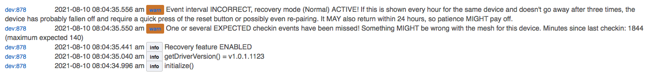

Is there anything I should look into the logs that might suggest what happened? Would restoring my latest backup be a good idea too?
I just checked, and there are a lot of lines of:
2021-08-10 07:50:00.527 am Z-Wave RX Queue is full
Also, 2 of my buttons both have the following log entries (both are zigbee buttons; these appear after all of the Queue full lines)
