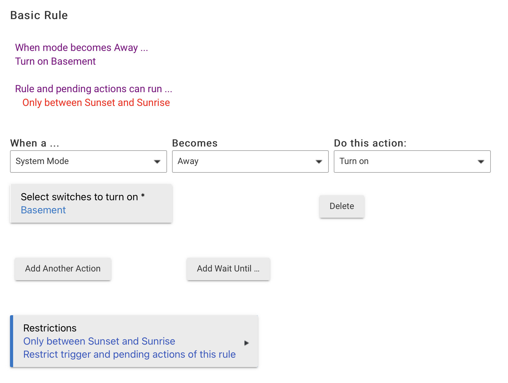

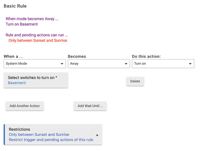

To do what you describe, I would do the following in Basic Rules (Replace Basement with “Sunset Lights”):
If you prefer to use Rule Machine, the following would do the same:
Required Expression: Time between sunset and sunrise
Trigger: Mode change to away
Action: Turn on Sunset Lights
