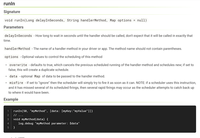

You could try using runIn(), but will need to call it each time the routine runs. The timing will not be exactly every 15 seconds, though, depending on where in the called routine it re-schedules itself.

So ended up using the runIn. I had thought of that before but wasn't sure you could call it from within the same routine. But my short test showed it worked. I only have this working a few hours in the evening, Christmas Light. So will see what happens this evening but it should be ok.
Thanks again for all the help.
runIn has two problems:
  1. It is being scheduled every time the routine runs.
  2. If the routine ever fails, the periodic polling will stop.
