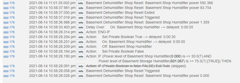

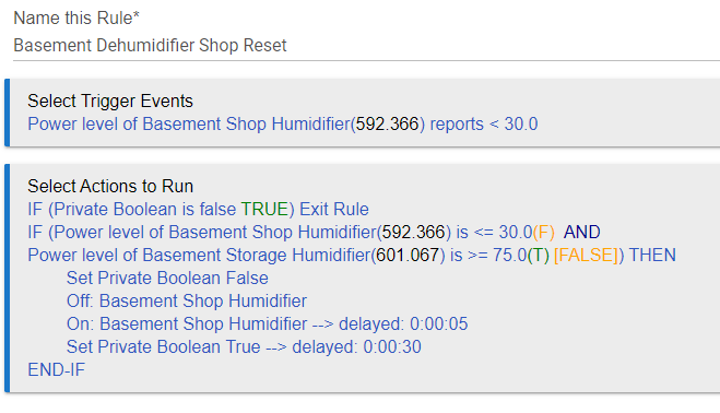

When the fault occurs Hubitat sees the power consumption go very low on the Shop dehumidifier and triggers my rule. I do not want another instance of this rule running till the first instance completes so I am trying to use the private Boolean. My rule will trigger and run as expected one time but for some reason I can't toggle the private Boolean back so my rule will never run again.
I see the delay end, the shop dehumidifier turn on, the rule retrigger but the private Boolean logic force the rule to exit but never see the Private Boolean turn back on after 30 seconds. Shouldn't the first instance of this rule keep running and only the second instance exit?
After I turn the dehumidifier back on, it needs a few seconds for the fan to start and drive the power consumption over 30, this is where I need to keep the rule from retriggering and allow the first instance to complete. Any other thoughts on how to rewrite this so I get the time delay but do not kill the rule before the private Boolean can be toggled back to True?
Make the test on PB be the Predicate Condition, instead of testing it in the rule. So the rule will only Trigger when it is true. As the first action of the rule, set PB to false. As the last action of the rule (after END-IF) set it to true again with a delay of 30 seconds. So, no matter what it will end up true, so the rule can run again, but the rule can only be triggered once in 30 seconds.

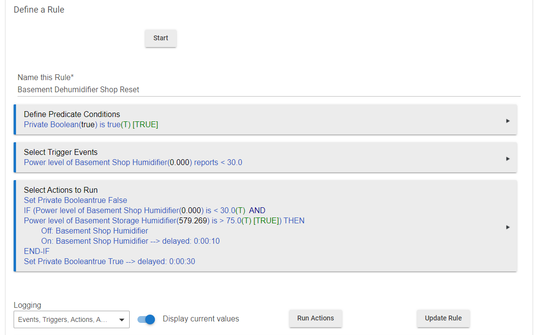

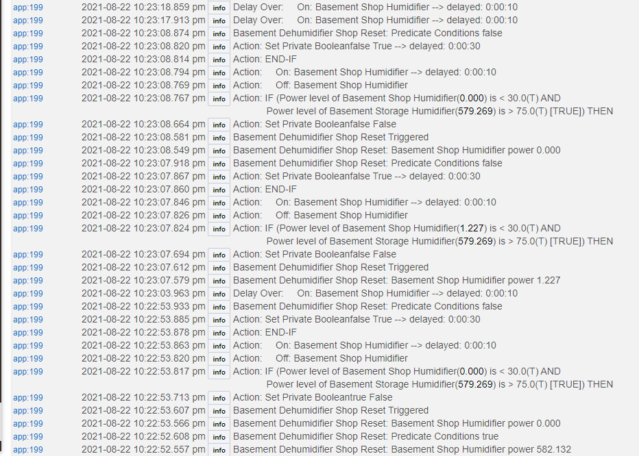

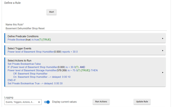

I rewrote the rule in RM 5.0 and added the Private Boolean as a predicated condition but still seem to have the same symptom, the switch keeps cycling on and off.
The log looks correct for the rule I have written, but this is not how the rule is behaving, the 30 second delay isn't really happening. If I were to take a movie of the dashboard the switch turns on and off repeatedly about every second. As a test, I stopped the rule and turned on the switch, it takes about 3 seconds for the switch to report back and show about 83 watts on the dashboard.
