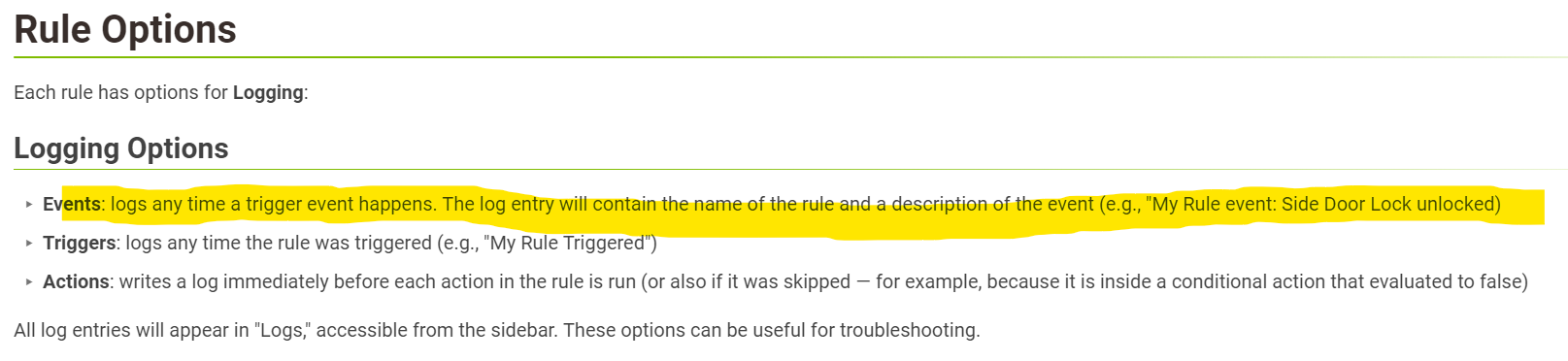

Looking in the documentation for Rule Machine 5-1 it is easy to get the impression that things should be written to the event log (Se screen shot).
Is there a way to enter data into the event log of a rule, for instance to follow the execution of the rule for debuging purposes?
Cheers,

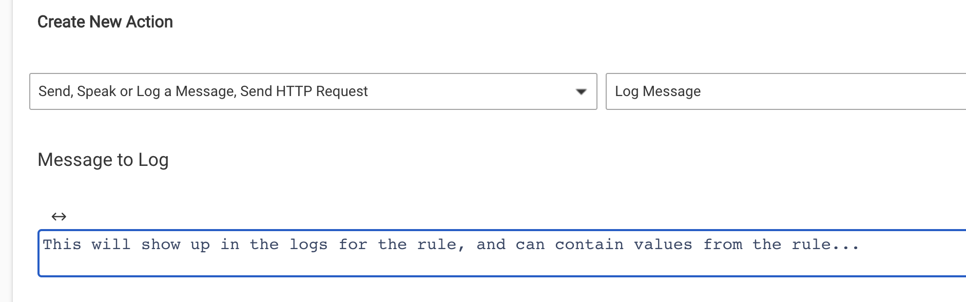

If you want to put something in the app's logs, that appear on the Logs page, you can use the action called Log. These will show in the logs irrespective of the logging selected in the rule.

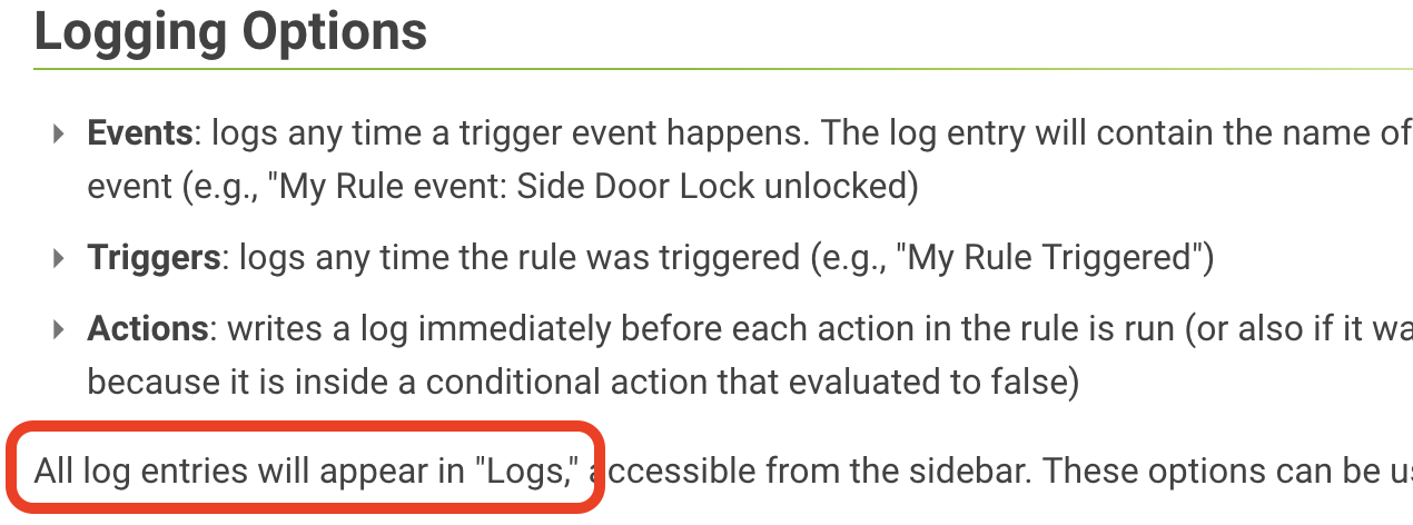

I think you highlighted the wrong part of the screenshot. :slight_smile: Look at the paragraph right below, and you'll see it notes that everything goes to Logs:
Presumably this note was added because you were not the first person to have this question...
