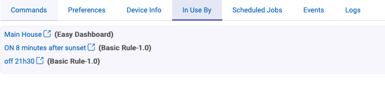

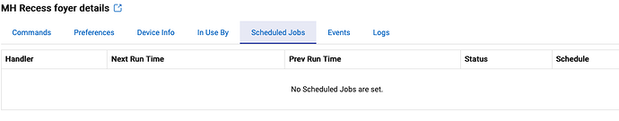

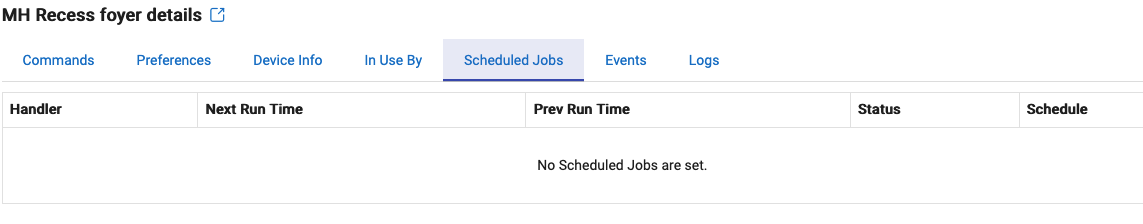

A zooz dimmer
Here is what I think might be useful for one device in error
You are missing most of the information I asked for above, although some of that can be helpful, too. Was one of those "command-off" commands produced by your rule? (This would be in the table you copied/pasted; it's a bit hard to read without the column headings -- and knowledge of what you rule is named.) If so, the rule sent the command, and you can eliminate the rule as the source of the problem (so no need to provide a screenshot or description of the rule).
You'd then be dealing with a Z-Wave network or device problem, which the above document also has some troubleshooting steps for. Maybe start by identifying if you have any "ghosts." If you haven't tried it yet, shutting down your hub, pulling power for about 30 seconds or more, then reconnecting is the way to fully reboot the Z-Wave radio and can help with certain problems, though this isn't usually one -- but it should be harmless enough to try (if you do it this way).
Since you're on a C-8 Pro, it may also be good to know: did you switch to Z-Wave JS? If you aren't sure but see a button in Settings > Z-Wave Details offering you to switch back to legacy Z-Wave (instead of switch to Z-Wave JS), the answer is yes. Either one should work, but it's still notable.
