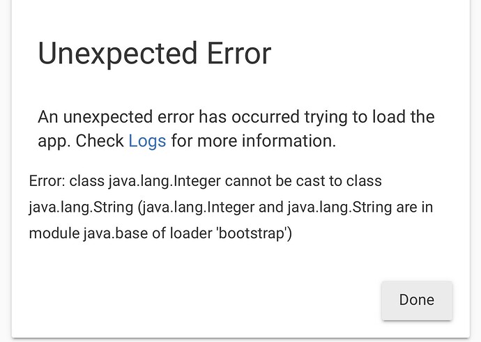

Rule w/ Error "Error: class java.lang.Integer cannot be cast to class java.lang.String"
Hub model - recently migrated from C8 to C8 Pro. Most everything has been amazing but there is one rule that is broken with the following error when I click to Select Trigger Events:
Error: class java.lang.Integer cannot be cast to class java.lang.String (java.lang.Integer and java.lang.String are in module java.base of loader 'bootstrap')
My events are a v-switch OR a cloud endpoint. My guess is the cloud endpoint is causing this as when I use my iOS shortcut to call the endpoint, it doesn't work.
This is a pretty simple rule that just turns off/on some lights before bed when I press the shortcut button on my iPhone 17.

The log does show a bit more (line 1309):
java.lang.ClassCastException: class java.lang.Integer cannot be cast to class java.lang.String (java.lang.Integer and java.lang.String are in module java.base of loader 'bootstrap') on line 1309 (method selectTriggers)
