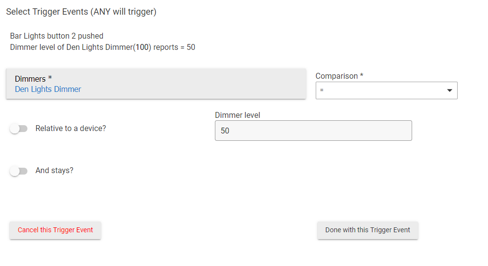

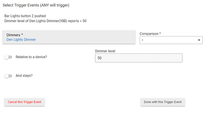

I am trying to add a trigger to a rule that will turn on a group controlled by a Zooz toggle Dimmer. I can't get it to work. Below is the configuration:
Does it not toggle the lamps when the Bar Lights button 2 is pushed?
For the 2nd trigger, would using >=50 work for your use case? As it is now, unless you are able to set it exactly to 50%, it won’t toggle.
Note: Toggle will turn on if off and vice-versa. If you always want it to turn on, then β€œSet” should be used instead.

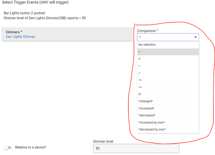

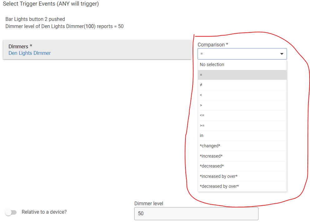

Yes, pushing button 2 on Bar Lights does work. There is no "Set" on the Zooz dimmer! I thought this was strange. See the options below:
There is, but that's an action (something you do to the the device), not a trigger (an event, often something that happened to the device). Equals would basically mean "just got set to" if that is indeed a trigger you're looking for, but that seems unlikely.
