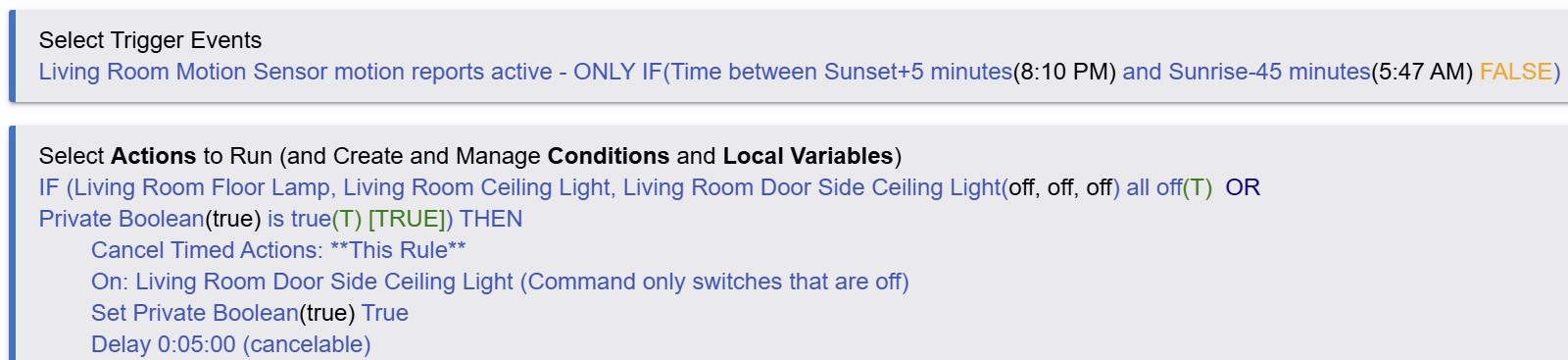

I upgraded my hub to v2.4.1.176 today and noticed a new bug related to rule triggers.
I have a rule that has an ONLY IF condition in the trigger.
After the recent upgrade it runs actions even when the ONLY IF condition in the trigger is false. Can you please look into it?
Found same issue, rolling back to previous (.175) build fixed it. Before I rolled back I tried updating the rules but that didn't fix it.
Please show the culprit rule.

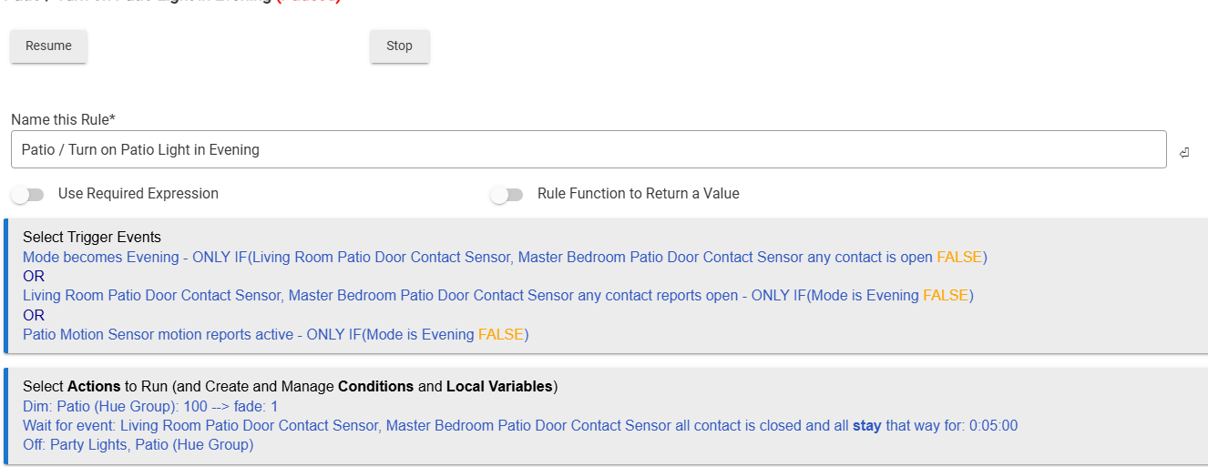

I had my patio lights turn on during the day because of the rules after updating as well. Here is the rule which is triggering.

Thanks. Here's the relevant part of my rule that's affected by the bug:
I am able to reproduce this problem. Looking into it...

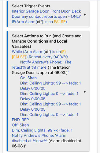

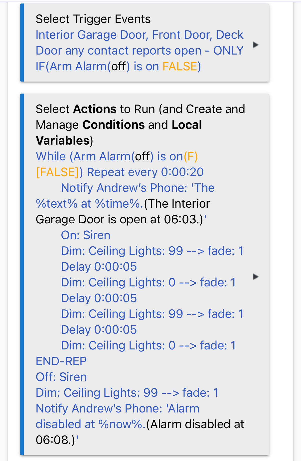

I know Bravenel indicated they could reproduce, but adding my rule that is broken immediately after upgrading as well. Just in case it helps narrow things down.
Only the alarm disabled notification is triggering when I open a door and the alarm switch is set to off. No other portions are activated. The rule works as designed when the alarm switch is on.
This bug found and fixed. Next release...

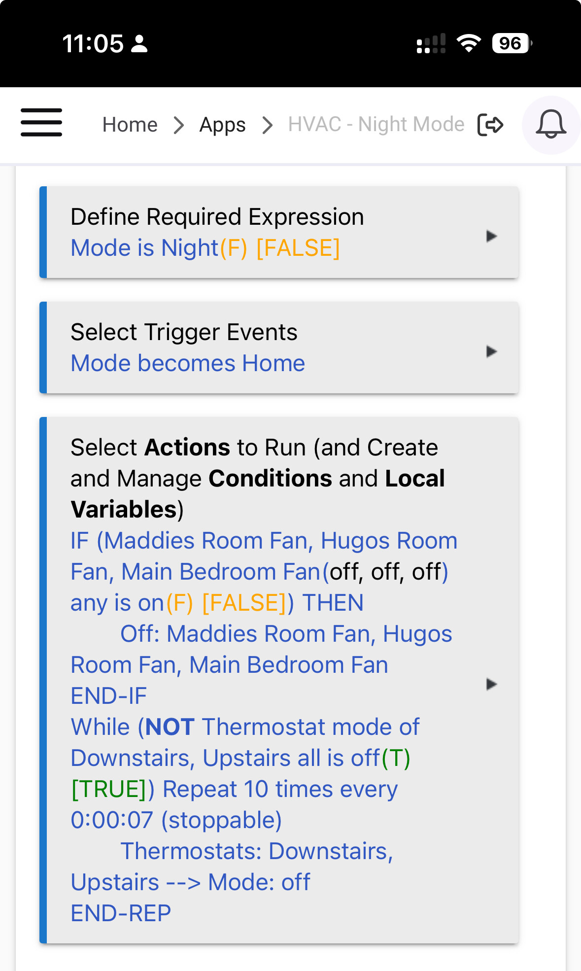

@bravenel I’m not sure what was changed in .177 to fix this bug, but some of my rules that worked fine have not been triggering for the last few days.
Eg this is the one I’ve noticed today that didn’t run.
Edit: I removed the second example, that was user error on my part. I’m turning on logging for the night to home mode rule as that has failed two days running.
