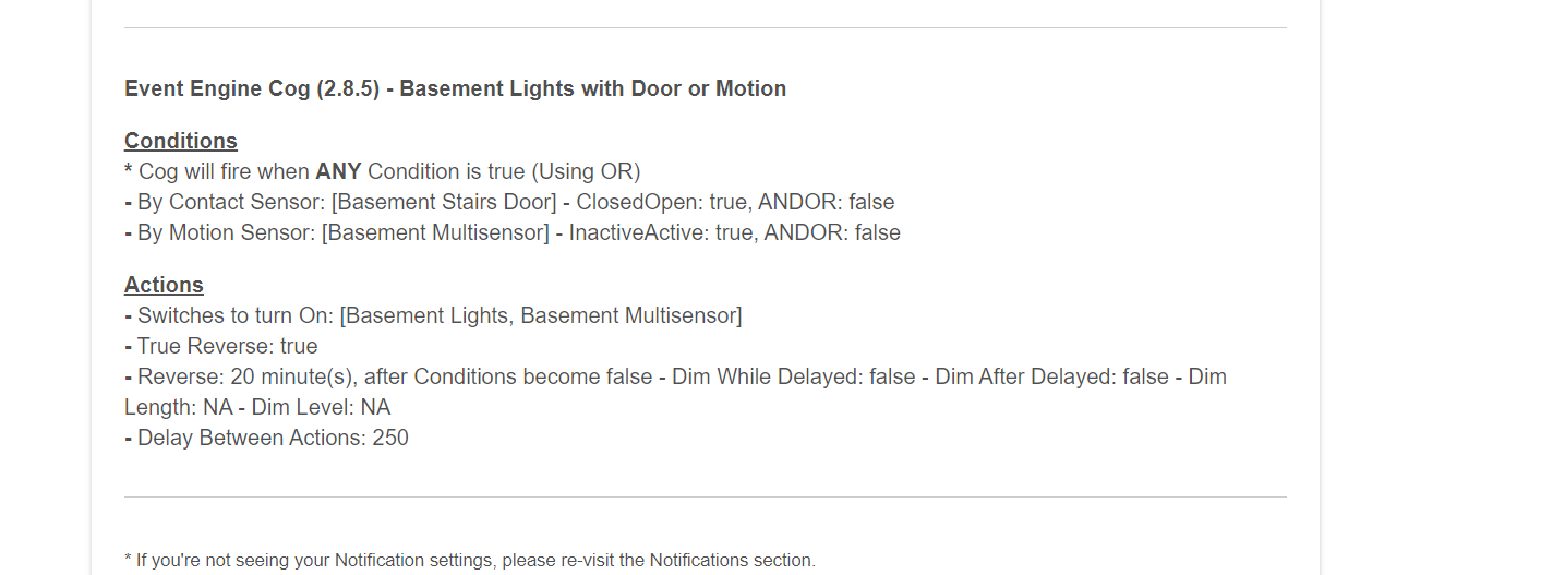

for me rules with motion and door together seem simplier n event engine..
ie
