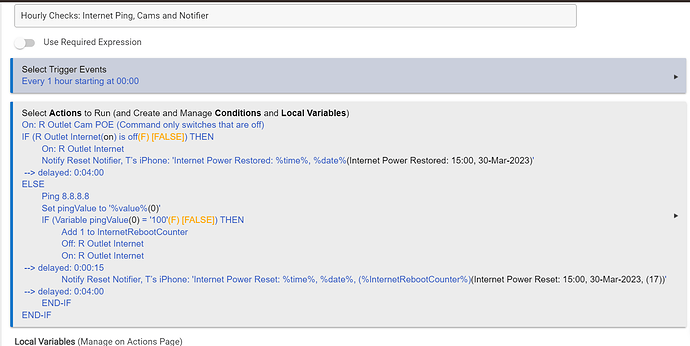

I have a rule that does maybe what you want. The router is plugged into a zigbee outlet.
Every hour it checks if the internet outlet (router) and my POE cams outlet. If they OFF for some reason then turn ON, escape rule.
If the internet outlet (router outlet) is ON already then ping 8.8.8.8, if it fails the ping then turn OFF router outlet for 15 sec and back ON. I found that a power cycle recovers it if hung up. Then send me a notification that it had to be reset.

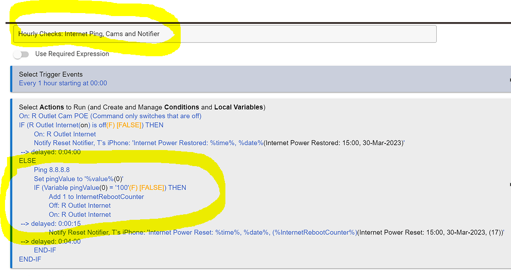

Thats what this part does. power cycles router if its not connecting.

Yes, that's the part of your rule I would like to try first, but as a newcomer I'm having trouble making a rule that looks like your's. Specifically,
(1) is pingValue a Local Variable you've declared, or something else? I can't reproduce your second line in the ELSE clause.
(2) I have declared InternetRebootCounter as a local variable (number) and seems to be counting up (Log %InternetRebootCounter% displays it value correctly.
(3) I don't understand how the results of the Ping(8.8.8.8) are determined or used for logic to stop pinging.
Here's what I have so far...

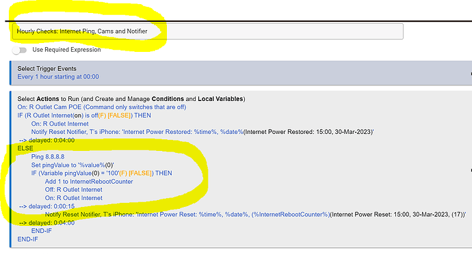

After a trigger this is all you need to make this power cycle your switch or outlet. Off, delay 15sec, On.
ping Value = 100 is what the Hubitat developers designate as a ping fail.
The rest of that rule is so I can track how many times it resets and send me notifications
Swap "R Outlet Internet" with your switch name.

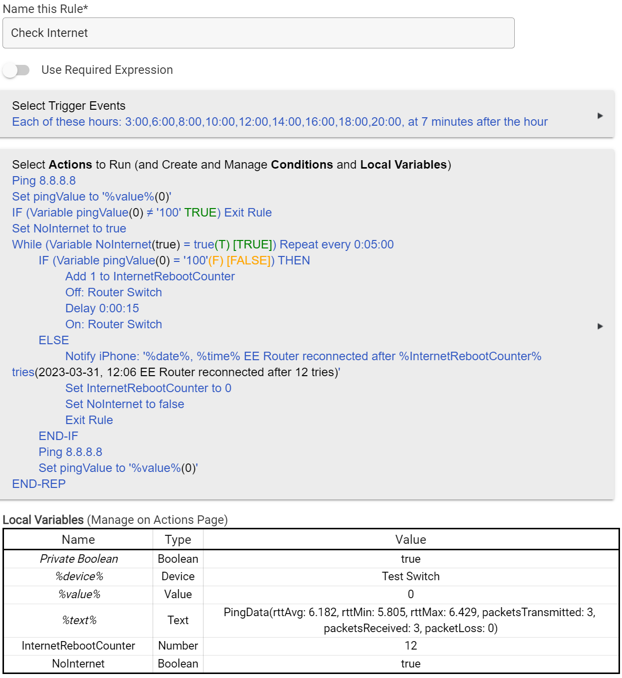

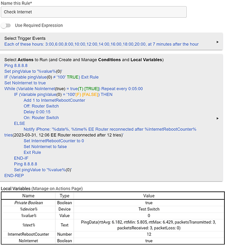

Got it. Key for me was to make pingValue a Hub variable, and not a private variable as I had it. This allowed me to make your second line. My intent was to check the internet connection a number of times a day, and if it's up, do nothing. If it's down, then try a router restart every 5 minutes until it's up. Here's what I got now (and thanks to all for your helpful suggestions):
Oops, I had to add a 2 minute delay after restarting my router to allow it to reconnect successfully....
That's neat and exactly what I am looking for (and also really should be an app!)

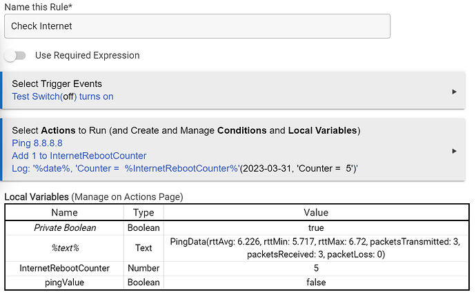

Quick question: I am unsure I understood how you captured the ping results. What is TestSwitch, and how do the ping results get assigned to it?
I think TestSwitch is a “left over” from his testing. The current version of his code never uses %device%.
The ping results go into %value%.
