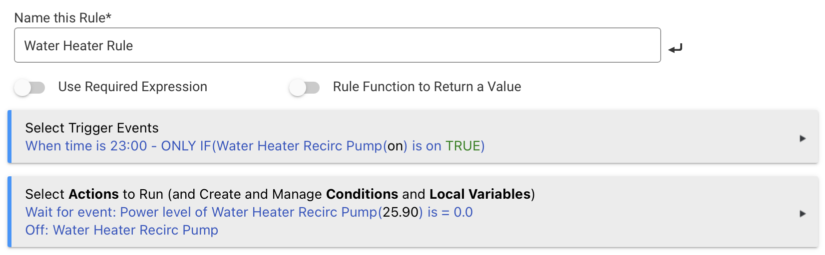

How about something simple like this:
The trigger is conditional upon the heater being on. So that the rule doesn't have to run if you have purposely turned the water heater off,

Here is how I would write it, just to add to the above list of very good ideas.
The "Wait for Condition" will not pause execution if the power is already 0.0. If not, it will wait until the power becomes 0.0.
I added a 5 minute delay to turning off the power to the water heater to allow it to finish anything its electronics might be doing after completing the heating cycle of the water if it was in process.

Just to be clear... a "Wait for Event" will wait until the hub receives the specified event. So, if the power was already 0, the hub would wait for a new event setting the power level equal to 0. The power would need to become non-zero first, and then back to zero.
"Wait for Condition" behaves as previously mentioned.
