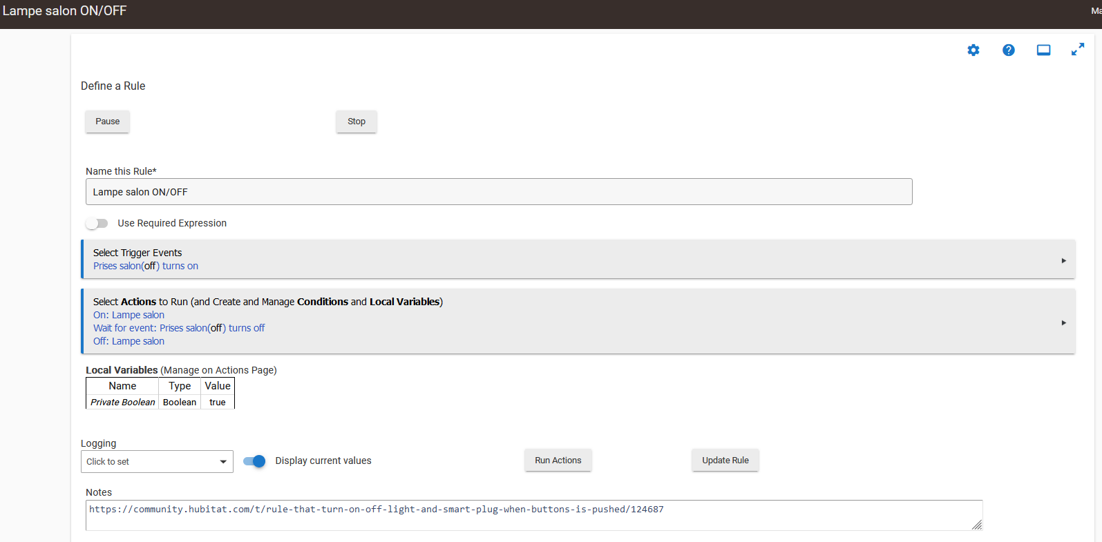

Hello, I'm still having trouble understanding the logic of the rules engine interface. It should be simple, but I still haven't figured out how the thing works...
I'd like to turn a socket on or off when I use a light switch.

The title of your topic says "virtual device," but I don't see any virtual devices in your description--or a need for any. If the below doesn't help, I'd suggest describing more about the automation you are trying to accomplish.
In general, assuming your device reports properly, the rule you want should be do-able a number of ways, perhaps most easily as this:
Trigger: Light Switch on
Actions to run:
On: Socket
Wait for event: Light Switch off
Off: Socket
(where "Socket" and "Light Switch" are the names of your devices)

This is a Basic Rule, for example.

That will work, but there is an outlier that could cause it not to work, if only briefly.
If the hub is rebooted, for whatever reason, while it's waiting for the switch to be turned off, the lamp will not turn off again until you flip the switch off and then back on and off again.
A number of ways to deal with it. I would use a trigger of change instead of on. Then use a IF.
