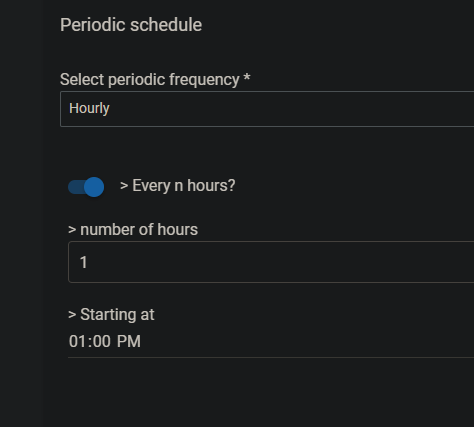

I assume you are trying to use Rule Machine? Confirming that will help provide more accurate assistance.
If it is Rule Machine, in your Trigger you will likely want to select Periodic Schedule, then select the relevant settings, i.e. hourly, etc.
Also in Rule Machine, you can trigger on "Periodic Schedule", and then "Cron String", then enter your string. For hourly, that would be "0 0 * ? * * *".
thanks. not sure how i missed that but i am good now
