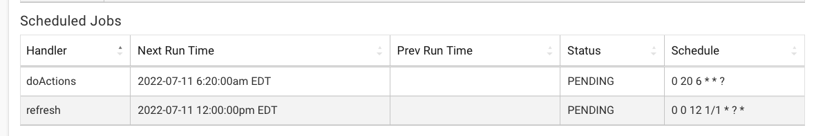

Okay you wanted to see it from yesterday? I dont know how to go back to that day.. the above is from right now..
Yes, but the schedule as it is doesn’t look like it has any weekend restrictions… though I don’t know for sure what the ā€œ**?ā€ Means…
Tagging @bravenel
Basic Rule schedules without regard to Restrictions, so in this case, for every day. When it runs, it is supposed to check if it is restricted, and if so, simply exit without doing anything.
I just created a simple one of these, with a time trigger and days of week restriction, and it worked as expected. Therefore, my guess is that your rule may be corrupted in some way. I would remove it, and recreate it, and see if it works. To make testing it easier, set the trigger time temporarily to a few minutes in the future, with everything else the way you want it, and see if it triggers or not (it shouldn't, since it is Sunday). Be sure to have logging on, as it will log that it is restricted when that time comes. If that works, correct the time, and hit Done.
If it fails, please let me know...
I created a new rule that turns on a light and runs M-F only then set the time 10 mins in the future . It did not run - but it the info under the gear icon looks similar..
It should look the same.
