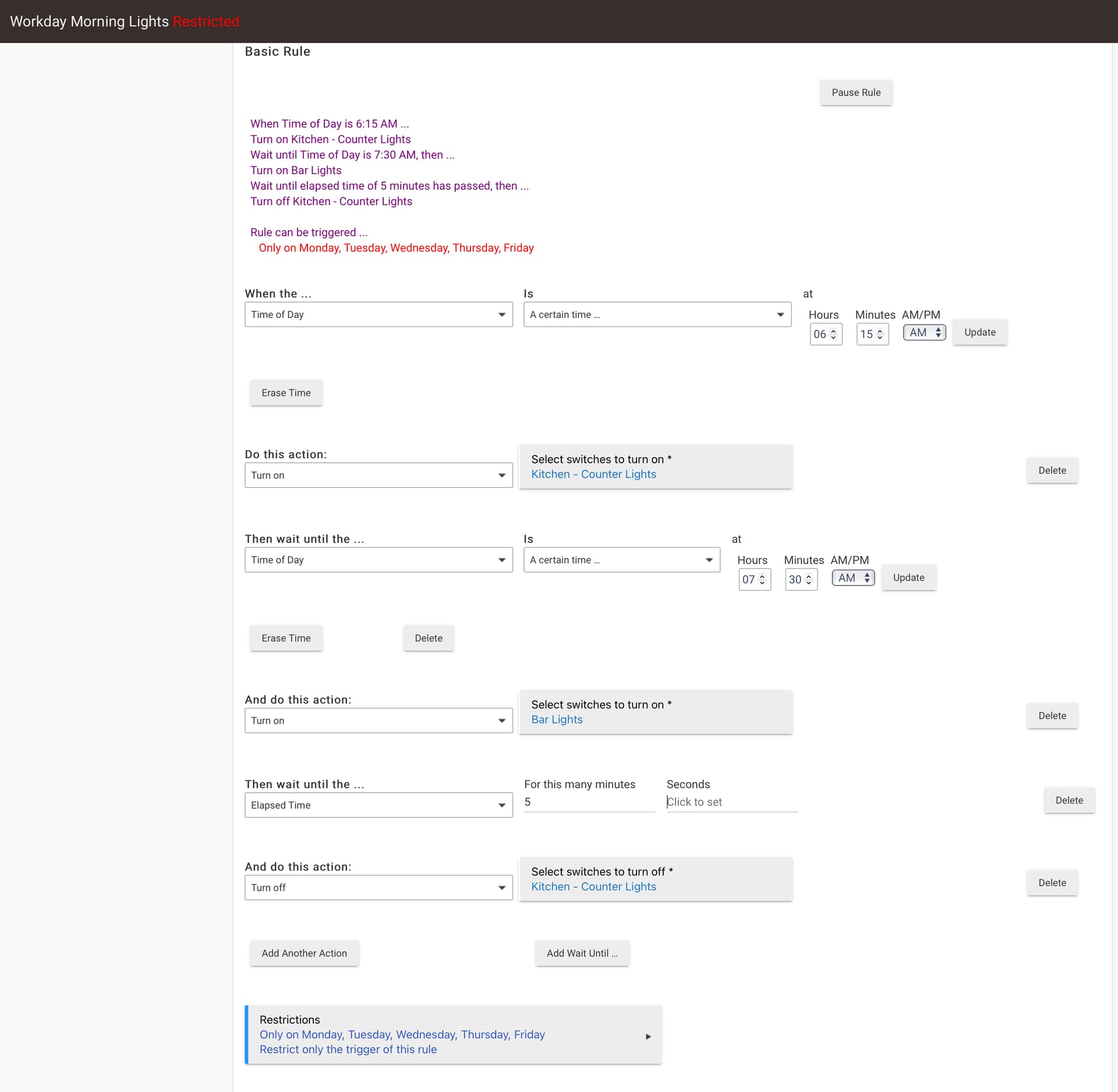

I have a rule called workday morning lights.
It suppose to run only on week days not weekends. It appears to me its setup right but it ran this morning. Any ideas why this is happening?
Here is the details on the device
It says it is restricted. Can you post logs showing that it ran?

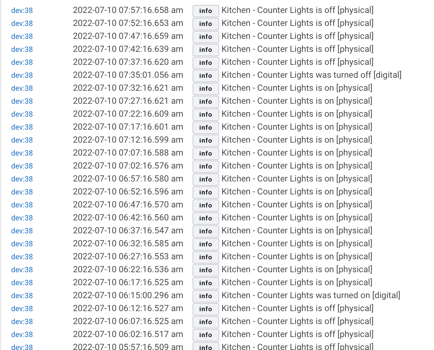

Also here is the log from the device - it says it off but its actually on - I wam looking at the light

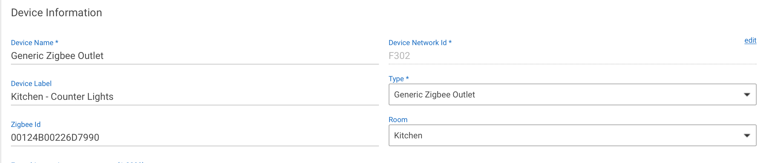

What kind of device/light is this?

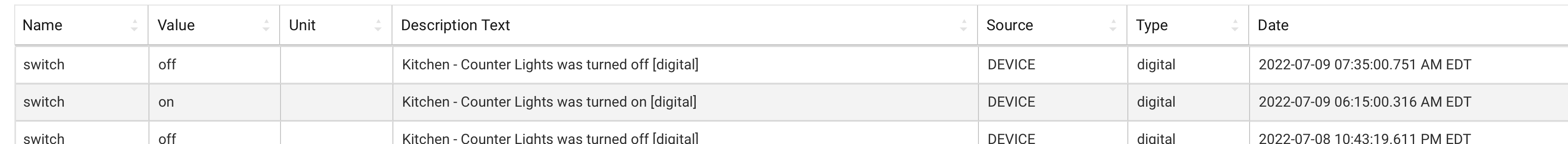

Here is the event log showing it turn on
I just turned login on..

Zigbee plug in module..

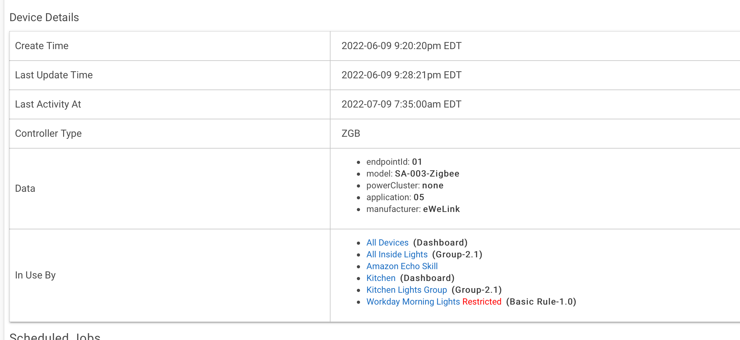

What rules and apps use this device? It is indicated on the bottom of the device page.

I sent a screen shot above..

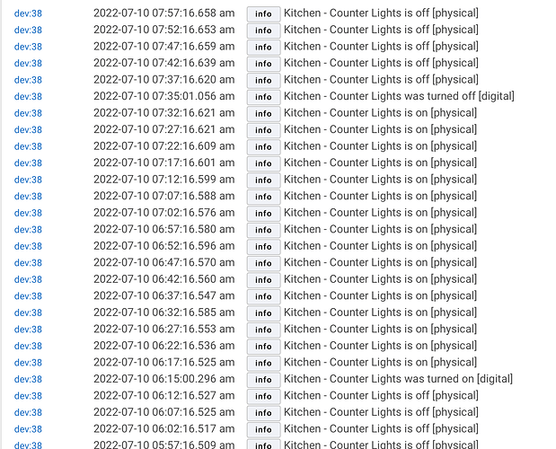

It ran again this morning - Here is the log of the switch.
Here is the rule log..
It doesn't appear (to me) its taking the day into account..

The restriction is indeed not working properly. It would have been interesting to see what was in the scheduled jobs (bottom of the config - accessible by pressing on the top-right gear) yesterday. It should show tomorrow’s 6:15 first action at this point, but on Friday after all actions ran, the next scheduled job should be for 6:15 the next Monday.
