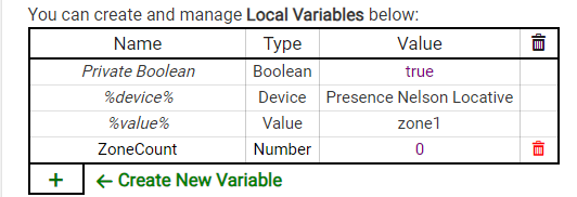

The “private Boolean” is a special beast. Private to the rule, but can be controlled much like a hub variable. You can control another rule’s private variable.
Oh so a Private Boolean is different than a private variable that I set to 1 or 0. Yes I've been using a variable like a Boolean, but instead it's a 1 or 0.
Maybe it's time for me to reading these two topics a little better. I admit I've just used hubitat rule machine, with not a lot of reading the documents that they have spent much time creating :man_facepalming:
Each rule can have only ONE “Private Boolean”… its own. You can create your own Boolean variable(s) that will also be private to the rule but they won’t have the special ability to be controlled by other rules.

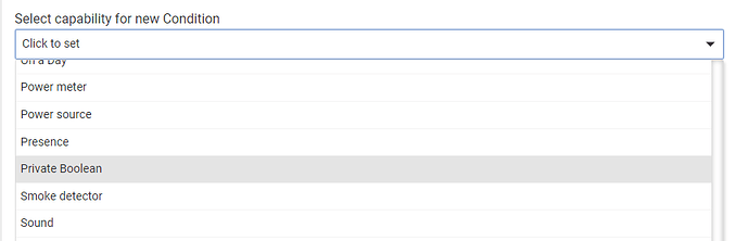

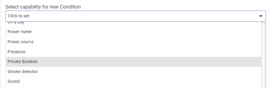

A private boolean is automatically created for each rule you make, it's the top one in the variable table...
When creating the condition, you will find the private boolean here...

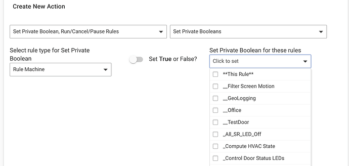

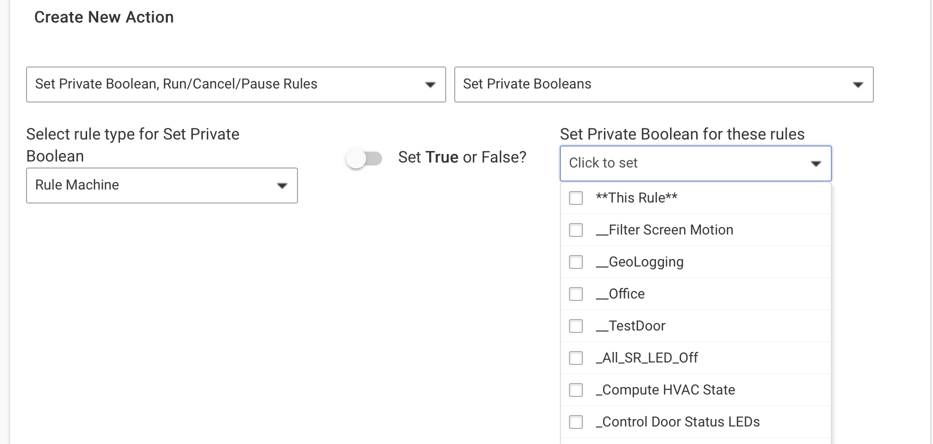

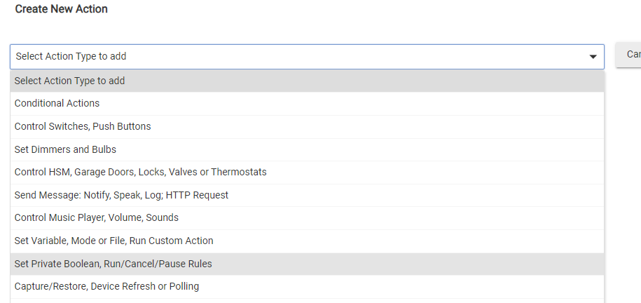

Same thing when setting it's state (true or false), you use the Set Private Boolean action.

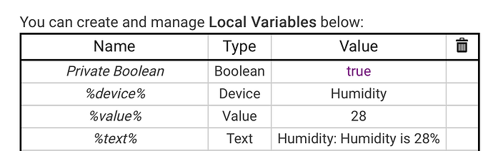

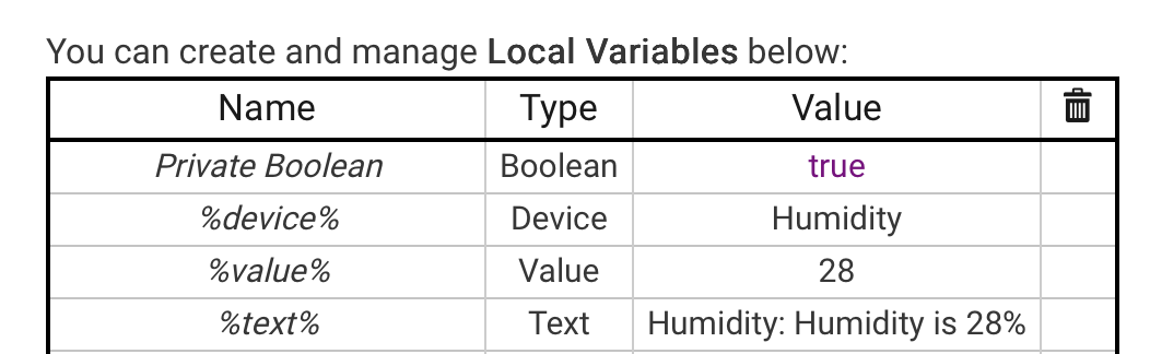

When viewing the rule for editing, etc., you might notice the value(s) of local variables looking “purplish”.
If you click on the value. And it’s Boolean, it will change from true to false or vica versa,
Other variables will open up for editing.
Nice for debugging or flipping that Private Boolean that got set wrong.
