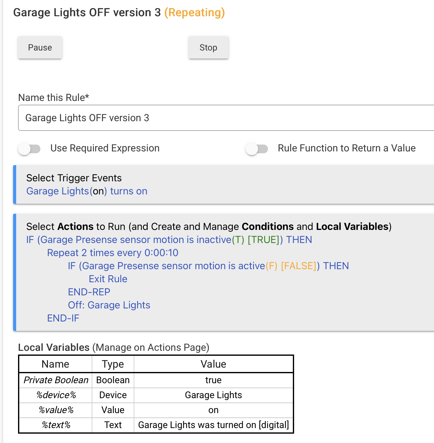

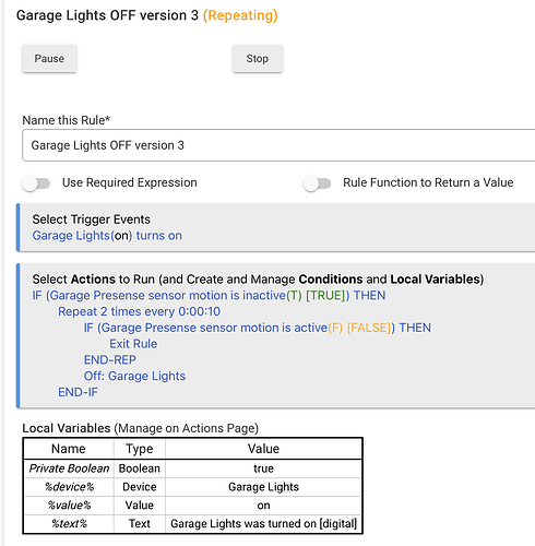

I had an older version of this rule, then I tried to add logic to it and it ceased working. I went back to where I started from, no luck. I deleted it, built a new one the way I had it before, (at least from my snapshot) and it still doesn't work...
Snapshots of rule and log below:

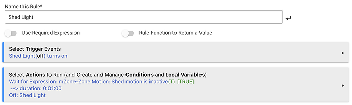

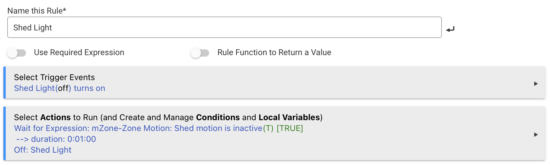

I don't think you need repeat action. A rule like what's pasted below should accomplish what you're trying to do:
Thanks, I assume in your example, any motion will 'interrupt/restart' the 1 min timer?

The rule you posted is missing an END-IF too... But the position of the one you have is odd -- it's somehow between the 2 stmts (vertically)... I'd expect it to show up there indented one more to the right, but :person_shrugging:
That's what I thought too... but it won't let me add the other one...
Yes.
Could you post your original rule?
This rule is properly formed, whereas the rule you posted previously is quite mangled. With that said, you can greatly simplify your rule (and decrease the work hub has to do) by using a rule such as the one I posted.
How would I un-mangle it? I must be missing something basic here.

I confess I can't make heads or tails of what your intent is with the rules you've posted, but if it's what I suspect, then Ashok's example above would be an excellent solution.
If what he posted won't meet your needs, then I'd recommend explaining what your objective is in plain language here so that folks can offer other ideas.
Perhaps there are situations when @james.michael.herber has observed that the "Garage Lights" do not turn off as anticipated?
If so, there are other ways to address that situation over using a repeat.
Editing the Actions as shown below should permit the rule to work as I think you want it to. However, I would recommend making the rule much more efficient.
I would think the Garage Lights Off needs to be after the "End Rep" as my guess is that he wants the lights to turn off if the sensor stays inactive through all the loops.
I would also suspect that if the sensor detects ativity, the lights will never turn off because the rule will not trigger again. The OP's "original" rule posted later has a trigger when the sensor reports inactive. This one does not. So -> Lights on Acitivity detected -> Exit Rule with no action. Lights are already on. So, it will not retrigger until the lights are turned off then on again.
