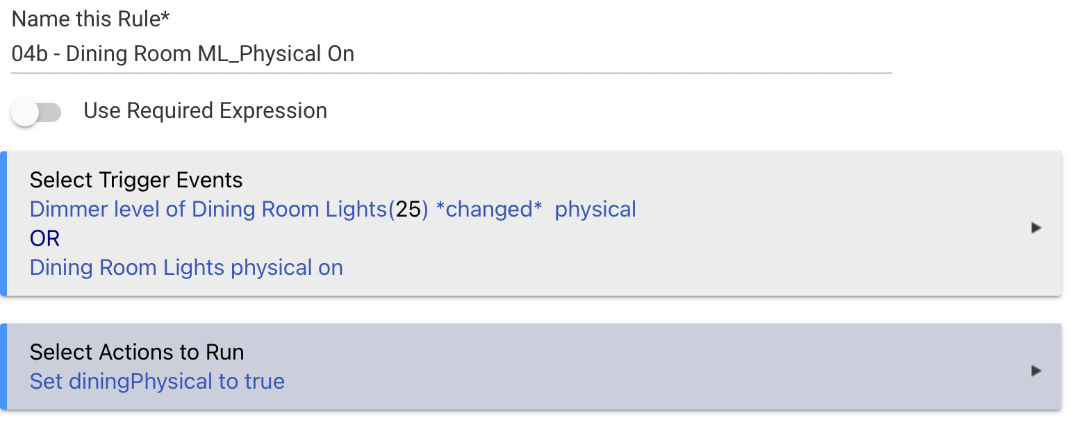

Here's another example:
Added physical dim triggers:
Device events show physical dim:
and event logged, but rule doesn't run:
Happy to provide more, just let me know what you need! Thanks!
